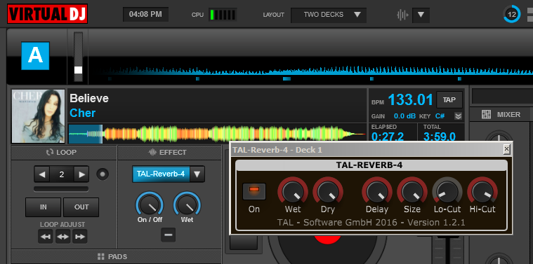

I did a test with this free one:
https://tal-software.com/products/tal-reverb-4
When turned all the way up that gives you 15-20 sec when you pause the track (with fxProcessing set to post fader of course)

OK today I finally got around testing this. Tested with TAL-REVERB-4:
1. No reverb tail. If I disable the effect, either from VDJ or using the plugin's own ON/OFF button, the reverb stops abruptly. I suppose the solution to this is to find a free plugin that can do reverb tails. I stress the word 'free' because I feel VDJ should be able to provide a decent reverb (such as Traktor's) with reverb tail out of the box. Lifetime upgrades are great but third-party effects require a separate license.
2. TAL-REVERB-4 looks tiny on my Surface Pro 4 display. I had a similar problem with FL Studio but later I learnt it has a "scaled" mode which makes plugin UIs bigger, maybe something like this is needed in VDJ unless there's already a workaround.
3. The VDJ UI could maybe expose at least 3 or 4 plugin parameters. Currently there are only two knobs that are mapped automatically to the first two parameters of the VST plugin and seemingly cannot be custom-mapped (but hopefully I'm wrong).

I think you'll get the best results if you get used to turning down/off the deck instead of killing the effect and expecting it to still run
Then you can take advantage of post-fader fx processing and basically all effects
Regarding the 2 knobs gui and the small vst GUI, I would ignore it. I wouldn't have the time to look st it or mess around with it using the mouse while djing anyway. So I would simply map it so that I had the needed control at my fingertips while DJing. As you can see in my video above you can map more knobs and buttons

@klausmogensen I didn't realise there was an option to make FX post-fader, but I don't see how post-fader makes any difference. Basically, I'm need to do reverb tails because its a very versatile FX and works well with the kind of music I play. In Traktor, the deck's signal is split into Dry and Wet, and the FX is only applied to the Wet bit. Then there is a knob to adjust the wet-dry balance. All FX in Traktor are pre-fader. When the Reverb "FX unit" is turned off, it continues to output the tail that resulted from the last bit of audio. So if the last bit of audio was a C-Major chord, then the tail will sound only like a C-Major chord. The switch simply cuts the input to the reverb FX, but not its output. This works regardless of whether the reverb is applied pre-or post-fader.
In Traktor, if you need the effect to stop abruptly, without tailing, each deck has FX routing buttons to do this.
If I use post-fader FX in VDJ I can get the reverb tail effect but only if the deck stops playing audio, because that's the only way to prevent any audio reaching the reverb plugin.

Continuing to process an effect that is turned off is only available with VDJ plugins, VST plugins can't do that.
I haven't extensively tried TAL-Reverb, but I see it also has an On/Off button and wet/dry knobs.
Did you try if you can get a tail using these instead of turning off the effect in vdj?
You can access other sliders/button using vdjscript effect_button and effect_slider.

Yes, I have tried that, but the on/off button on the plugin disables all processing, just like disabling the plugin in VDJ.
I own Mulab MUX so I could patch up a reverb FX in parallel with the dry signal with a level control before the reverb, then map the level control to a button on my controller. That would get me what I want, with any reverb plugin. Otherwise it's a case of finding a reverb plugin that can switch off its input whilst still letting the dry signal through and the reverb tail. I have looked at a few but none of them can do it.
If someone knows a nice reverb that can do this, I'd much prefer that because with MUX it's a plugin inside a plugin inside VDJ, which spells trouble during a live set.
