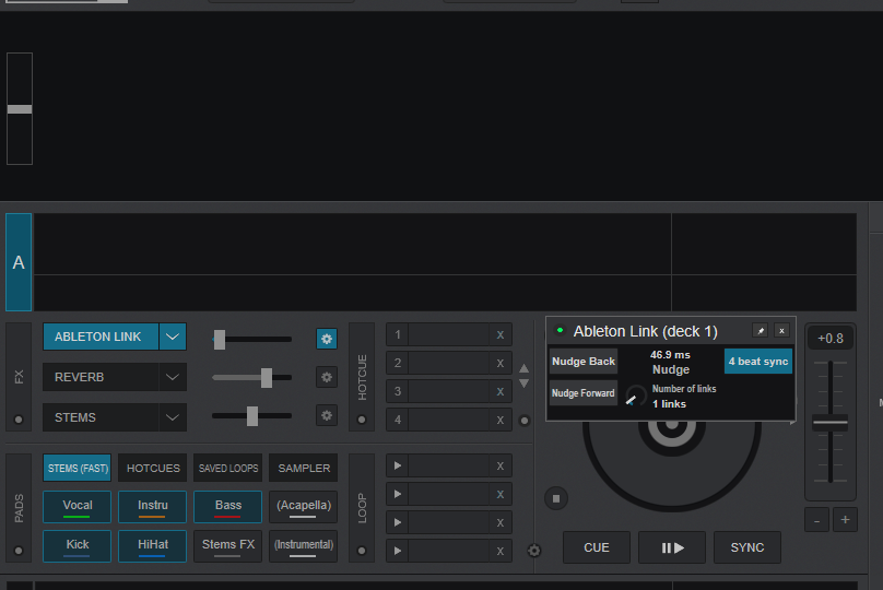

The plugin doesn't seem to work reliably. Sometimes it doesn't sync up with another app, when that app was running first. While it does if the other app is started later, or restarted. Sometimes it's even required to restart Virtual DJ before it will sync again.
And the issue in this isn't the other app, as it works fine with other Ableton enabled DJ software, such as Serato. Both when starting it before, and after.
Posted Sat 04 May 24 @ 9:01 pm
I haven't experienced that. Connections can be lost, of course
But VDJ always shows how many other Ableton Live instances it's connected to, so it's easy to see
