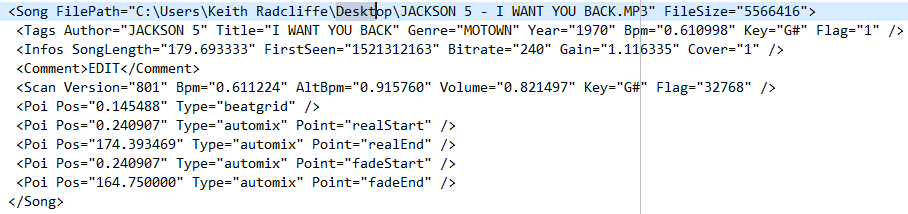

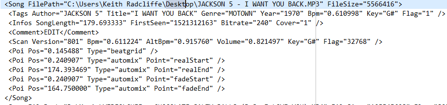

I have tested and when the gain is manually adjusted with the auto+remember setting it adds a "gain" value to the DB.
Default gain:
After changing setting and gain:
Posted Tue 28 Aug 18 @ 8:26 pm
