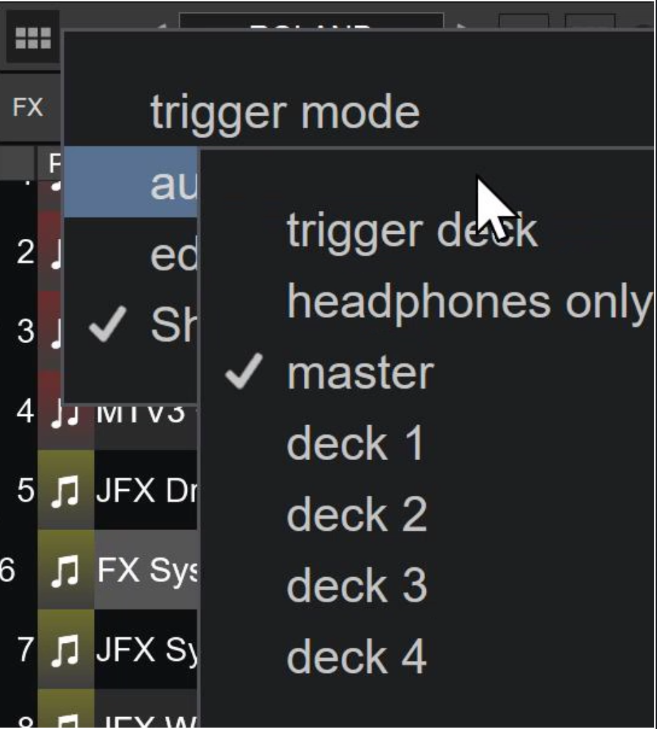

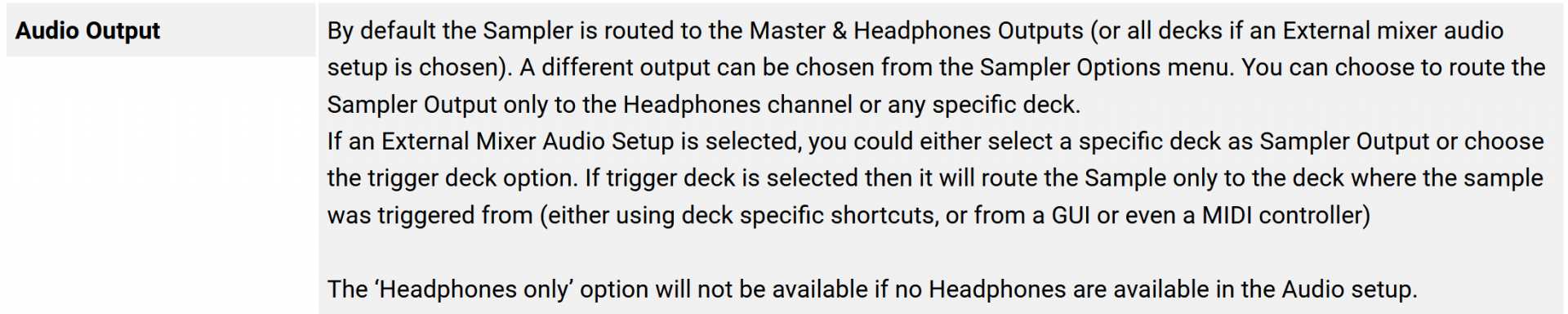

there is only one sampler in VDJ
you can force its output to deck 3
deck 3 sampler_output
or select deck (or remove) using
sampler_output popup

The problem is that it is not configured to output the sound of the sampler in deck 3.
I don't know where I have to map deck 3 sampler_output
I have a knob mapped to sampler_volume_master, but that doesn't get the sound out of me for a deck.

you can map deck 3 sampler_output to oninit

I just got it.
I finally get the sampler out of deck 4 and can preview it.
Thanks to NICOTUX and MG_1978.
