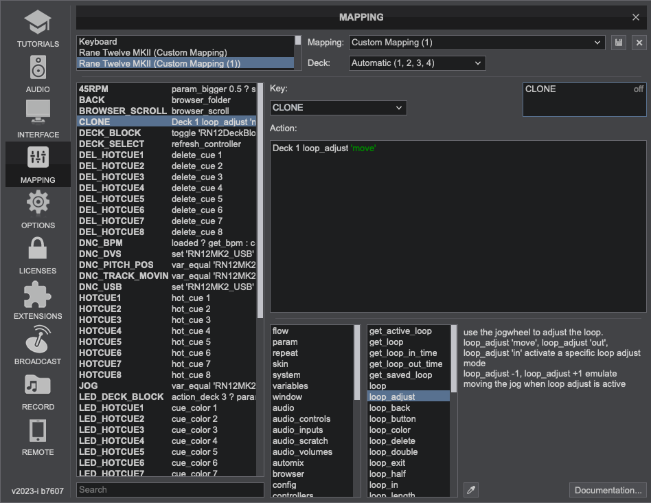

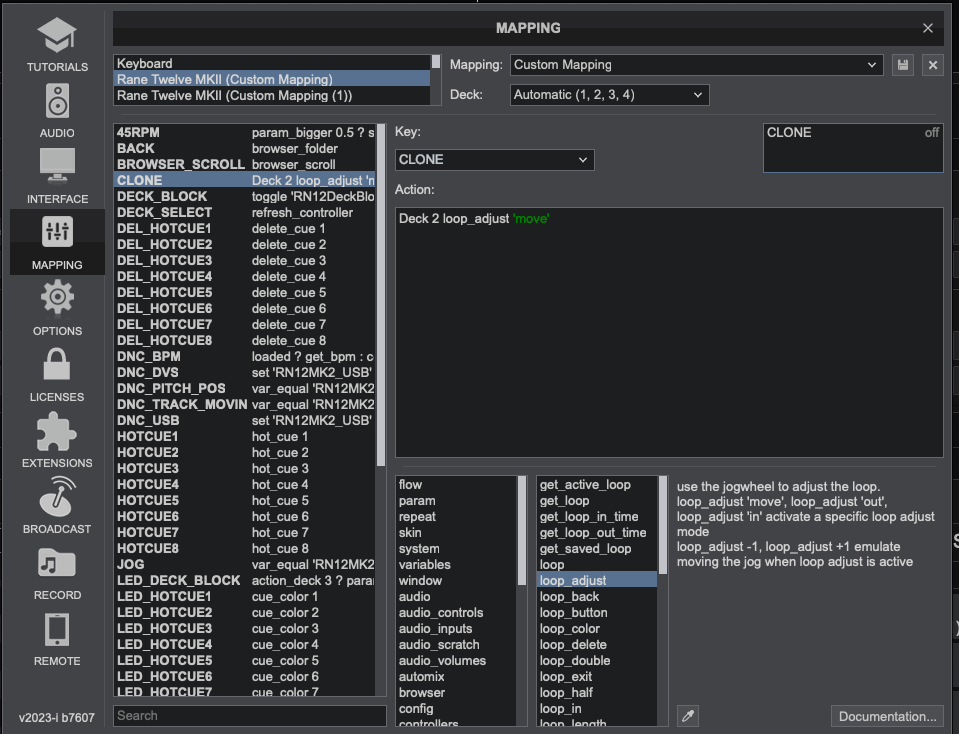

I'm looking for help with a script I've used for many years that stopped working after version 2023-i b7607
For Left Deck:
Deck 1 loop_adjust 'move'
For Right deck:
Deck 2 loop_adjust 'move'
This script simply stops the platter in the Rane 12 and lets me use the platter to move (scrub) the set loop. I've used this script for many years with many different controllers, but for the last 5 years with the Rane 12s. Its very important to my workflow and video sets.
I appreciate any help to resolve this.
if it did work and now it doesn't report it on the technical forum.
I was told by support to post it in here and a tech would respond. I did post it in the Technical Support Thread. One person suggested removing the deck x command but this breaks the working version and has zero effect on the current version. Its broken and I can say for sure its a BUG.
