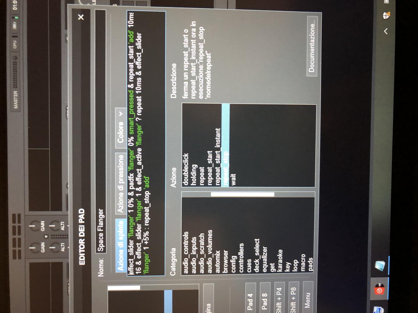

so, slider zero, fx on, rs to move the slider like 8% every 50ms, give a count of 10 or have a query to turn the rs off when % = 80
yes! when pad is pushed or in toggle mode, like padfx smart_pressed
mg_1978 wrote :
[quote=locodog]so, slider zero, fx on, rs to move the slider like 8% every 50ms, give a count of 10 or have a query to
i have mapped: down? effect_slider ‘flanger’ 1 0% & effect_active ‘flanger’ on & repeat_start ‘add’ 10ms & effect_slider ‘flanger’ 1 +2% & effect_slider ‘flanger’ 1 80% ? repeat_stop ‘add’ : nothing : repeat_stop ‘add’ & effect_slider ‘flanger’ 1 0% & effect_active ‘flanger’ off
is work, but not in toggle mode too :(
rs scripts don't run that fast, quickest you can have reliably is 30ms
obviously it won't work as a toggle, down ? doesn't have a toggle like state
if you want like padfx smart_pressed, use padfx.
slider zero, padfx smart_pressed, rs 50ms 10 times, query fx on ? true increase slider : false repeat_stop
@Locodog: thanks to your help I found the right script:
not quite what I had, but good stuff, In future post the actual script & not a screenshot [sideways camera shot, eugh], makes it easier for everybody.
effect_slider 'flanger' 1 0 & padfx 'flanger' smart_pressed & repeat_start 'lic' 50ms 10 & effect_active 'flanger' on ? effect_slider 'flanger' 1 +8% : repeat_stop 'lic'
