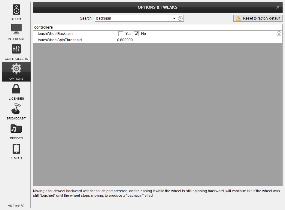

Try to search for this and give it a try with the settings...

Even with that ^ setting to a lower value, you wont have the same results like the TM. Its mostly related to how lose or tight the Jogwheels are, and on the DDJ-RR (and most of DDJ- units) they are quite tight to allow you performing long backspins.

It was a prt sc from My settings, and I dont need that backspin effect you would like, try to change the settings on your own..
