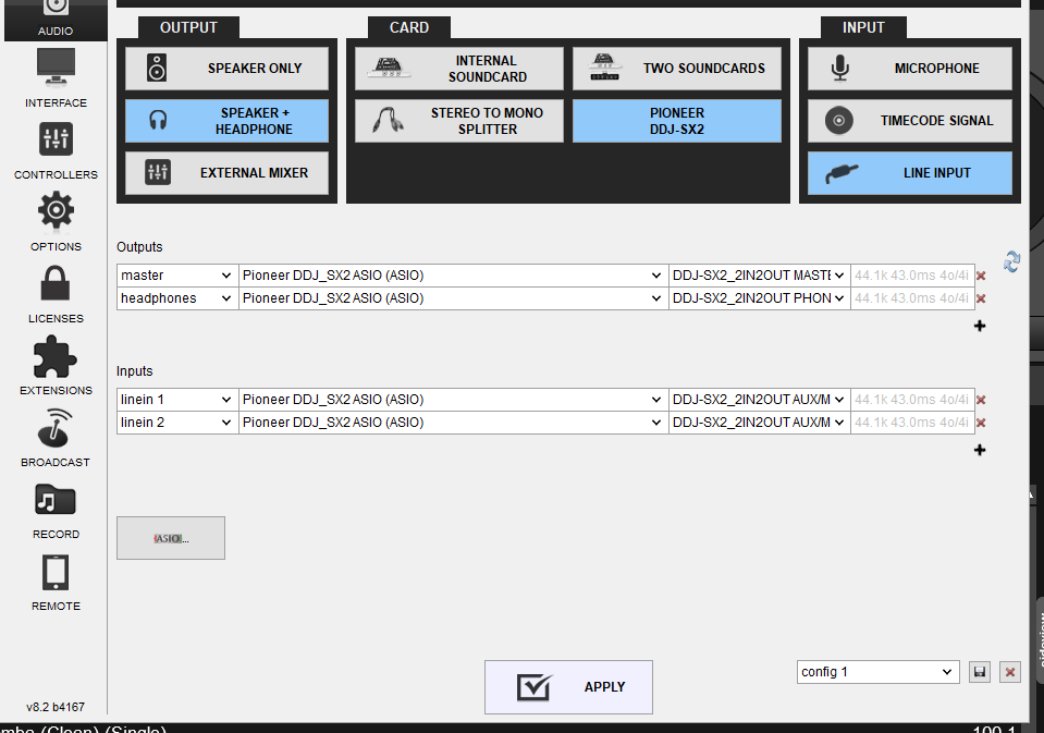

As of Builds 4189, the Inputs of the Pioneer DDJ-SX2 can be used for Timecode/Line inputs in VirtualDJ.
For those who wish to test, Build 4189 is currently in Early Access, so you will have to enable the EarlyAccessUpdates setting from VirtualDJ Options and restart, to automatically update to the EA Build.
The sound card of the DDJ-SX2 should be now offered as 2IN/2OUT and 2 stereo inputs should be available to use as Timecode or LineIn inputs.

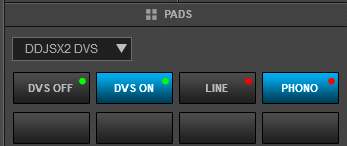

The new mapping* files now offer a DDJSX2 DVS Pad page, which can be selected from the Pads of VDJ GUI and offer DVS ON/OFF Pads 1 and 2 to set the unit to either the "Controller" mode or the "DVS" mode. When the DVS mode is enabled, 2 additional Pads (3 and 4) are offered to select the DVS Input types.
* requires the factory default mapping to be chosen from Controllers tab

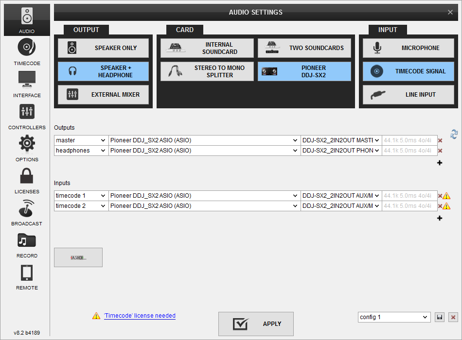

The most important part of this test, is to see if the Audio Interface of the Pioneer DDJ-SX2 is switched to 2OUT/2IN, thats the name you should see if you look at the list of the available sound cards if you click in VirtualDJ Audio Setup and if all went well, the special Pioneer DDJ-SX2 button you see at the top of that window, should offer this "new" sound card name.
By default, the Timecodes are not added to the Audio setup, so you will need to manually add them. Use the TIMECODE SIGNAL button you see at the top of the Audio tab of settings.
Your Audio setup should look like the one shown below, with the exception that instead of linein1 and linein2, you should have timecode 1 and timecode 2 lines..
It is advised to use the Pioneer ASIO for this test. Not sure if WASAPI properly offers the Inputs necessary for Timecode.
If something not working properly , and the above have been followed (so dont use the LINE/PHONO source positions), please provide a screenshot of your current Audio Setup in VirtualDJ.

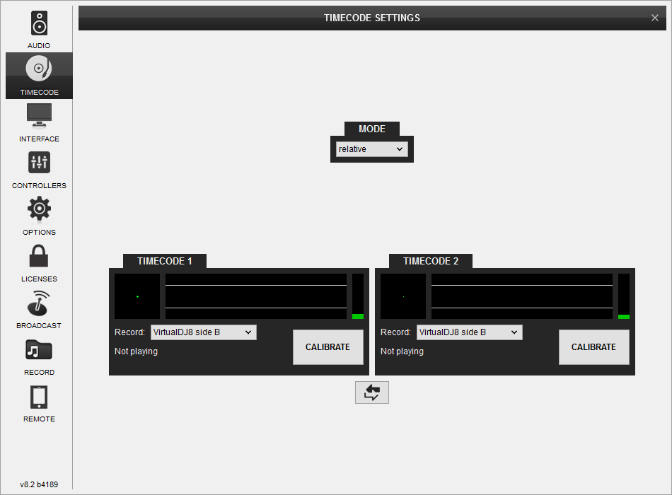

Pre-posting Update: While trying to get additional screenshots including one containing the actual calibration failure pop-up after taking the following 5 screenshots VDJ opened and accepted the calibration made while using a preamp WITHOUT a preamp connected with the SOURCE selectors to PC/USB position. I'll add more information at the end of the post.
The following is the audio setup used:

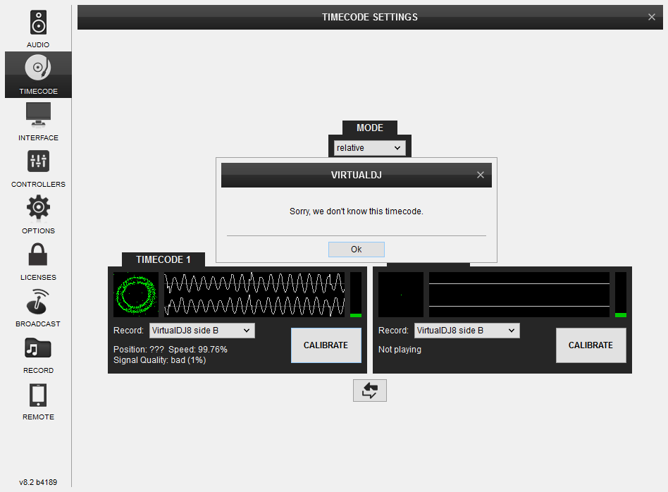

These are the results with the SOURCE selectors to PC/USB position (Left is on, right is off):
If you look very closely there is a difference between the timecode when running and when off, but calibration would inform me there was no timecode running/fail.
These are the results with the SOURCE selectors to the PHONO position:
These are the results with the SOURCE selectors to PC/USB position AND with a preamp:
These are the results using WASAPI (Simply changing ASIO to WASAPI on the audio settings dropdown):

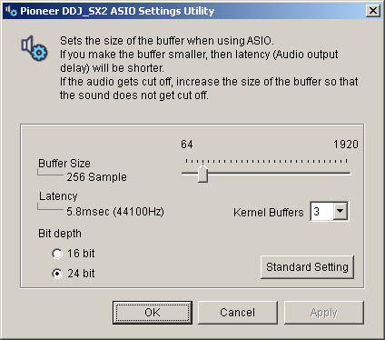

When in the Pioneer Utilities / ASIO settings window I do not see an option to select Phono or Line Inputs for the USB Inputs. I see the following:
Additionally, in the separate DJ software there is a Deck Setup panel under Audio Settings that allows you to switch between Turntable, which enables phono compatable inputs, and CDJ, which sets all channels to line level inputs.
I can confirm that simply starting and exiting the separate DJ software, at least while on the Turntable setting mention above without VDJ running, allows VDJ to read the timecode signal without a preamp, and when the DDJ-SX2 is put into standby and then turned back on this ability is lost and VDJ can no longer read the timecode signal.
