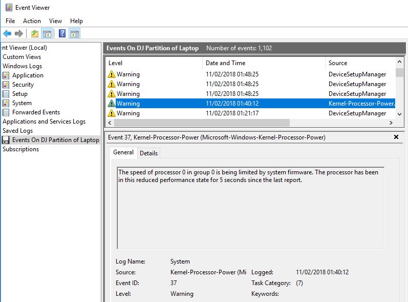

Damn, for the first time in a while, had major issues with version 3967 on Staurday night (10th Feb).
Every 2 songs, it'd stop for a second, then carry on.
Was like that from 10pm til I finished playin at 3am.
Did 3 reboots during the evening, luckily had my tablet to use as backup (with splitter cable so still had use of 2 decks!)
Had a spinny wheel pop up when each time it happened.
Brand new Denon MC4000 controller, tried 2 diff usb cables, 1 that came with, and previous one I used on my old Numark Mixtrack Pro 2.
Using external Seagate 3tb drive as have music/video on there, but that is only 4 months old.
Laptop is a HP 15-ba043na model, AMD a12 quadcore cpu, 8 gig ram, 2tb hdd etc.
However, I looked thru the event logs for the eve as there were no error logs for VirtualDJ, and found a few: Error Event ID 37: which refers to: 'The speed of processor x in group y is being limited by system firmware. The processor has been in this reduced performance state for z seconds since the last report' - which seemed to co-incide with the times of the songs stuttering.
I'm now in the process of reinstalling Windows 10 from scratch and then test Virtual DJ again with the Denon MC4000 and Seagate external hdd and will advise of results.
Just wondering if anyone who has had issues with songs pausing on Windows 10 Home 64bit, check the Windows event logs under: control panel, admin tools, event viewer, windows logs (click on the drop down) then system, see if you have had any: Error Event ID 37 show up in there (it'll show as below).

A quick Google tells me that it's related to power saving settings. Have you configured (optimised) your PC for DJ use?
Reinstalling Windows won't help, as it'll probably be set by default to save power. You need to go through your PC config and make sure everything is set so that your PC has maximum power at all times.
Posted Mon 12 Feb 18 @ 9:57 pm
Including stopping USB hubs and ports shutting down to save power too.
Posted Mon 12 Feb 18 @ 10:02 pm

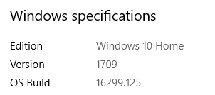

But... I think it may be down to that Spectre patch that Microsoft put out as they have now updated it, and have the new build installed of windows 10 home x64, as of 14th Feb and will test further tomorrow (Friday)

Further update, have now Windows 10 home 1709 build: 16299.248 installed as of last Thursday, used VirtualDJ (same build I had previous) and had only 1 glitch/pause all evening on Saturday 17th Feb, so it was possibly down to a Windows update being installed previously. So, fingers crossed!
