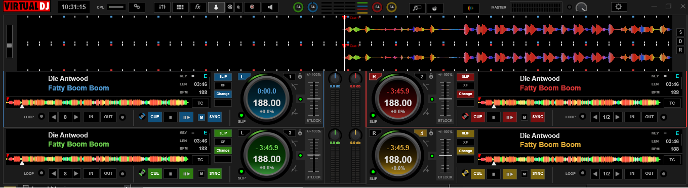

Small bugs
4 decks with external mixer layout, the white triangle on the songpos doesn't line up with the actual playhead [not repositioning after mixer shrinkage]
2 decks, custom buttons rack [is it called a rack?] visibility not 100% reliable [try have just fx, sampler & video racks visible]
Posted Sat 18 May 19 @ 4:42 pm
Dont see this. Care to post a screenshot ?
Adjusted a couple pixels in 2.01, but not sure if thats what you have seen. BTW, i have the skinPlayheadShadow setting to No, in order to get best alignments
Fixed in 2.01 re-download
Posted Sun 19 May 19 @ 9:03 am
locodogPRO InfinityModeratorMember since 2013
2.0
Posted Sun 19 May 19 @ 9:37 am
hmm kinda weird. I believe the inverted white triangle in your song progress is probably showing some Saved Loop ?
Judging from the Times, the Play Head should be at the beginning of the track, but i dont see that. I really cant reproduce.
Posted Sun 19 May 19 @ 10:07 am
TC or Mic button need to be shown for the bug to happen.
Posted Sun 19 May 19 @ 11:01 am

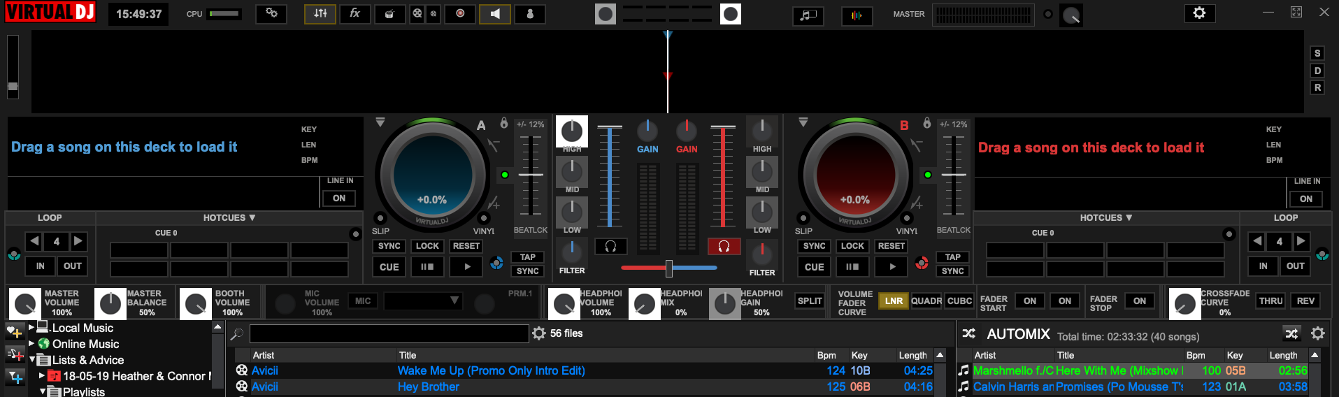

Hi Babis
I've been using your Blocks 1.2 skin for a long time. I have just downloaded your updated Blocks 2.01 and have found an issue with the graphics. All the rotary controls have a square background that is cluttering up the screen on my Mac. Looking at a pic posted above this doesn't appear to be happening on the PC version. It's also happening on the 4 deck version too. I'm using build b4918.
System Specs;
MacBook Pro 15” 2017, 2.9 GHz Intel Core i7, 16 GB 2133 MHz LPDDR3 Memory, Radeon Pro 560 4096 MB, Intel HD Graphics 630 n1536 MB, macOS Mojave 10.14.4, 500gb SSD, external WD Passport Ultra 2Tb HD containing Music, Video & Karaoke databases.
Posted Sun 19 May 19 @ 3:00 pm
Fixed now, please re-download
djles.co.uk wrote :
... have found an issue with the graphics. All the rotary controls have a square background that is cluttering up the screen on my Mac. .
Yes, i am aware of this issue on Mac. I am afraid you will have to wait for next VDJ Build though. Have you kept the previous Blocks skin version to use until next update comes ?
