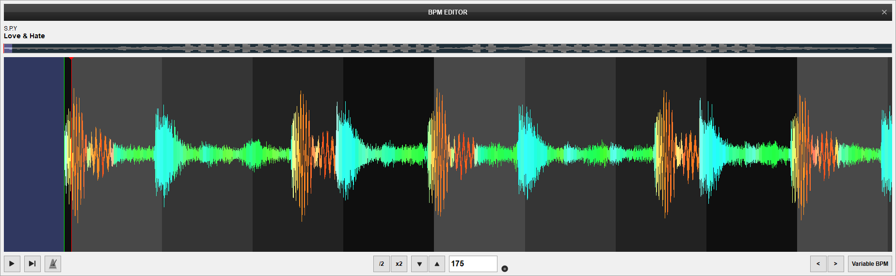

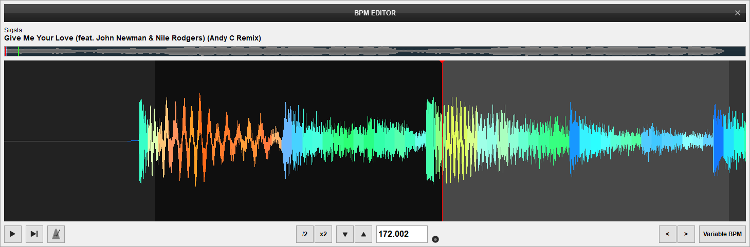

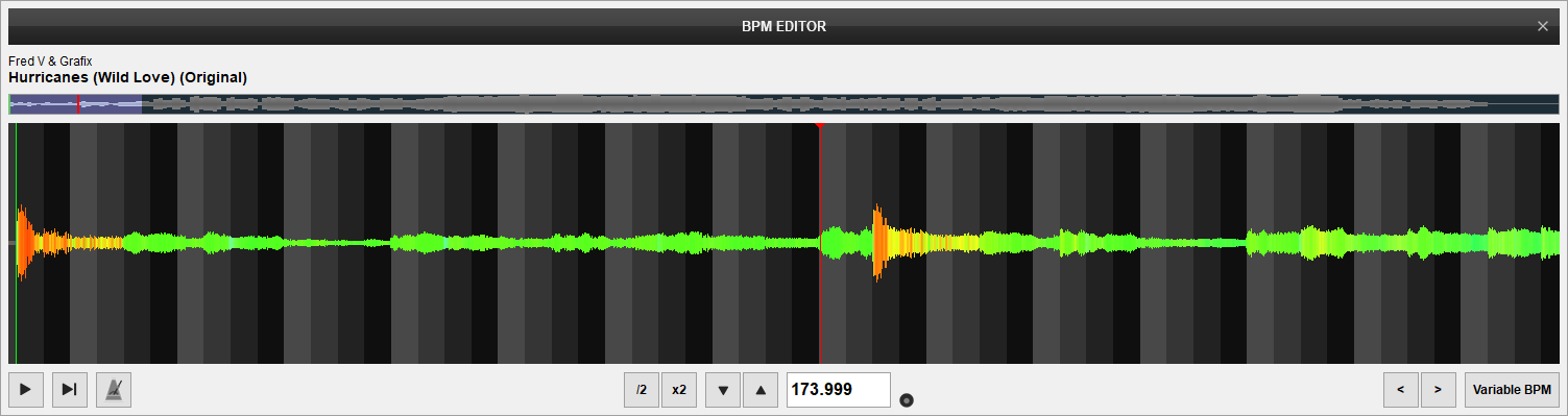

This seems to be having problems again. I think it is still better than it used to be but I am still getting tracks where the first beat is detected before the track starts or in a period of silence.
First beat before start of track:
10 - Sigala - Give Me Your Love (feat. John Newman & Nile Rodgers) (Andy C Remix).mp3 from RAM Drum & Bass Annual 2017 4m14.7s
Other more general bad detections:
Luca Debonaire - Walking on Clouds.m4a 03m43s
Shapeshifter NZ - Stars (Hugh Hardie Remix) (Hugh Hardie Remix).mp3 04m51s
Fred V & Grafix - Hurricanes (Wild Love) (Original).mp3 03m52s
S.P.Y - Love & Hate.mp3 05m38s
Posted Wed 16 May 18 @ 11:51 am
SerinePRO InfinityMember since 2013
RAMM300D-022-Frankee-Drop_It_Low.mp3 4m03s also detects two beats out of phase before the start of the track.
Posted Thu 17 May 18 @ 9:57 am
AdionPRO InfinityCTOMember since 2006
I've found the songs on Deezer, and for me
S.P.Y - Love & Hate
look correctly detected
Frankee-Drop_It_Low
is one beat off
a little-bit off-beat
Indeed 1/4th beat off or so
Posted Thu 17 May 18 @ 11:03 am
This is what I get for the first three. The first beat should be right at the first hint of waveform for all of these. Love & Hate isn't so bad (but is audibly off) and the other two are at least a beat out.
So maybe the question is more, why are songs which are presumably the same giving completely different analysis results?

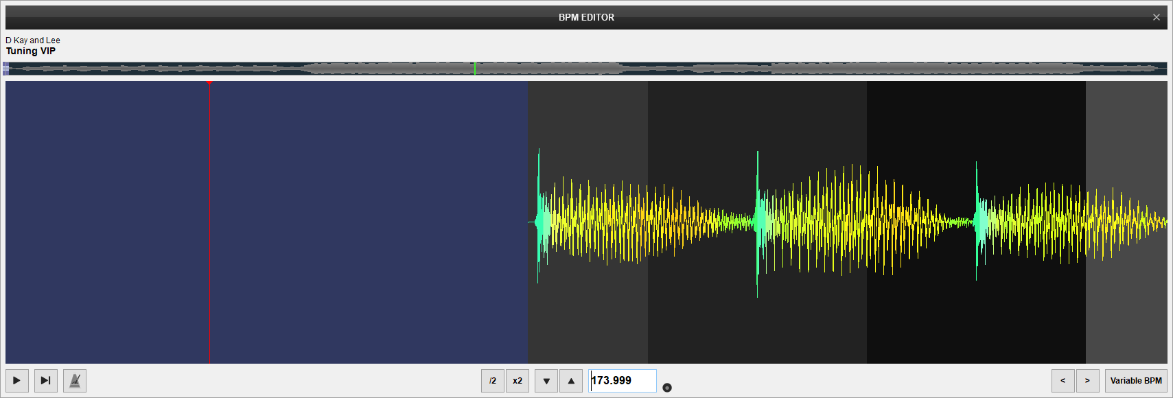

RAMMLP14D-017-D_Kay_and_Lee-Tuning_VIP.mp3
D Kay and Lee - Tuning VIP (05:35) from Andy C Nightlife 5
Is also analysing with the first beat detected off beat, before the file starts.
