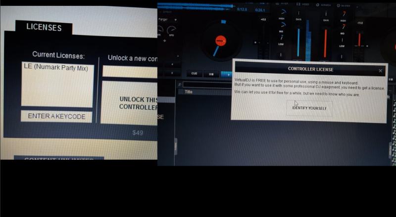

I bought for my son Numark Party mix midicontroller. I registered through Numark, where I got the serial VDJ 8.2. LE. I registered in VDJ, but After 10 minutes of me but still shows this window and stops working Numark. After the restart it doing again
I do not use my account as it needed to work. Someone advise me? thanks!

Can you post a screenshot of the entire LICENSES tab ?
Most likely you have to enable the LE mode in that window instead of the Home one, or else VirtualDJ will work in full features for 10mins.

I also tried it, but the result is the same.

Reason pointing the Mode out is that in the screenshot above, i see Automix running and Search in the Browser, which both are not available in LE mode.
Can you please post here a screenshot of the LICENSES tab and a screenshot of the AUDIO tab as well ?

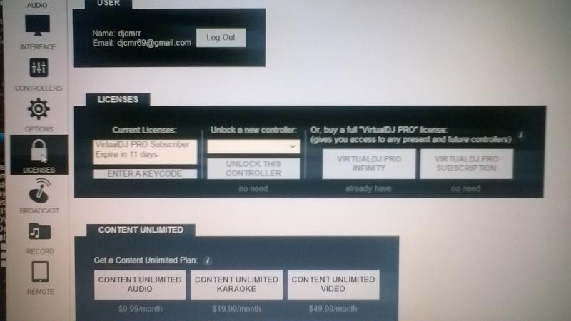

Hey everyone! I have purchased and used the Partymix as a DJ in a bar setting for about 6 weeks now. After my last gig I got the message that my controller would stop working......... so I purchased the license on a monthly basis. It shows on my panel as being there. However, last night I had a gig and when we went to connect me to the RCA cables, I could not get any sound out of my mixer! I LOST THE JOB! I couldn't figure out why it wasn't working. Worked fine all day, works today just fine (tho I don't use a RCA type system at home of course). My real question is DO I HAVE TO BE "ONLINE" WHILE WORKING IN ORDER FOR THE CONTROLLER TO RECOGNIZE MY LICENSE?
Posted Mon 27 Feb 17 @ 9:34 pm

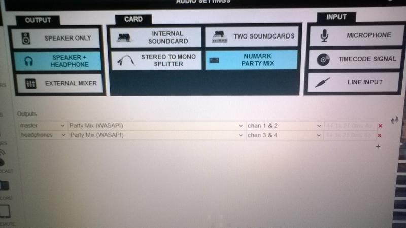

What is the Audio setup you were using with the "RCA system" ?
For the subscription license, you need to login once, and if not logout or no internet connection is available, then you should be ok (but you need to login every couple of weeks, just to make sure your license is validated)
Just make sure the license.dat is generated in /VirtualDJ folder after VDJ is closed in case you have some write permission issue
Posted Mon 27 Feb 17 @ 9:42 pm
DJCMRRPRO InfinityMember since 2015
OUTPUT - SPEAKER AND HEADPHONE
CARD - NUMARK PARTYMIX
INPUT - NOT USING
OUTPUTS
MASTER - PARTYMIX (WASAPI) - CHAN 1&2
HEADPHONES - PARTYMIX (WASAPI) - CHAN 3&4
IT WORKED JUST FINE THE LAST TIME WITH THESE SETTINGS.

Any chance the "Home" mode (full browser - limited controller) was selected in the Licenses tab ?
Posted Mon 27 Feb 17 @ 10:04 pm
Now i really feel stupid as I don't see anything about Home mode in my license tab........
Posted Mon 27 Feb 17 @ 10:35 pm
PachNPRO InfinityMember since 2009
There seems nothing wrong with your licence or settings.
One thing you could check is that windows does not grab the controllers sound interface as default audio device. That could block VDJ from using the soundcard.
Make sure to set your inbuilt sound card as default audio device.
Additionally set the option exclusiveAudioAcces to yes. That will prevent windows sound to play through the speakers.
