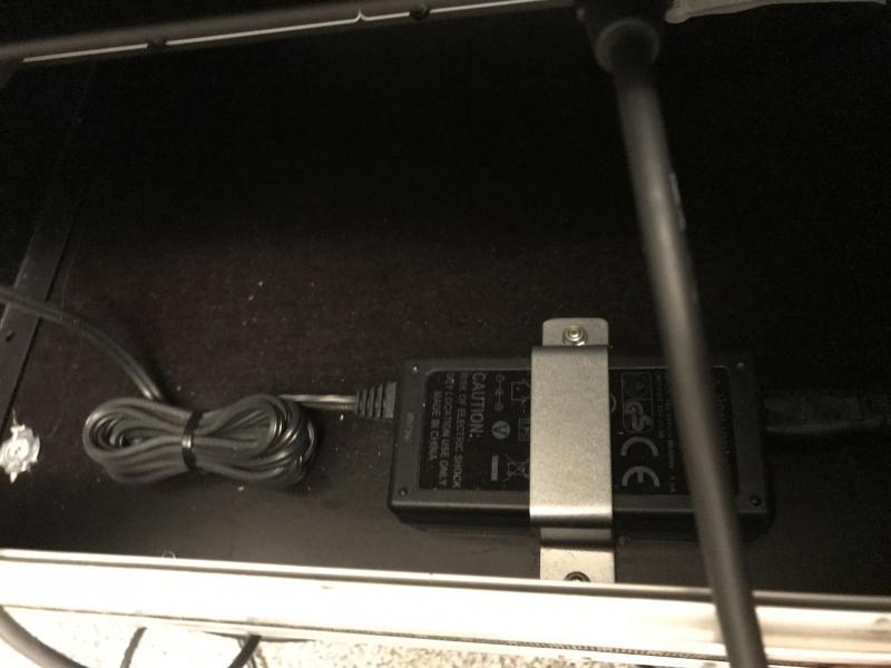

Absolutely agree with all the above, with the addition of: Master Balance, Sample Volume, 3 Independent Combo Mics, Filter Knobs, Volume Attenuator switch on the back, A 3 Band EQ on the Master and 3 Band EQ on the Booth. What happened to Zone features on mixers? that was good also. Funny even these bigger controllers don't have what we actually need.
I personally am sick of making these fixings for the external power supplies.
Posted Wed 03 Jan 18 @ 7:12 pm
