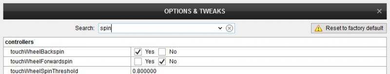

How are your VDJ settings?
Try to play with these(I don't think this will help, but you can try anyway):
Sorry If I'm not really helping. I'm just guessing around.
Maybe we find a solution this way.
