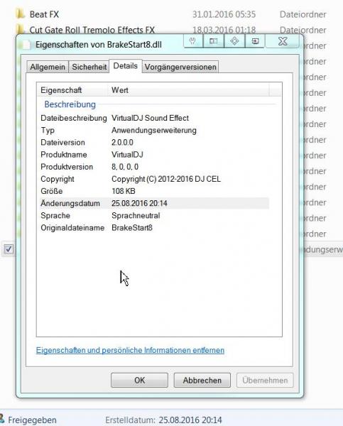

There is no 2.002 .
This is the Version , thats I download Yesterday again , and install it new.
The Error on it keep also.
Posted Thu 25 Aug 16 @ 7:14 pm

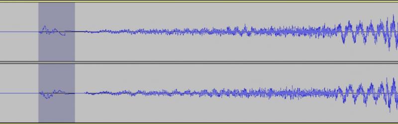

I have to fix another issue when the song starts:
Posted Thu 25 Aug 16 @ 9:28 pm
Ok thank You , i test it later :-)
Was is there for a error also to fix?
What happens at the start?
I can not see, is there a clipping?
Posted Fri 26 Aug 16 @ 4:59 am
Ok I have test it now.
At first it was just better, and he has nothing registered with RampStart & Rampstop. After a time it's happened again.
The error is therefore as yet.
But I have noticed since the sale in the DLL still 2,000.
Are you sure it was uploaded properly?
Posted Fri 26 Aug 16 @ 4:18 pm
