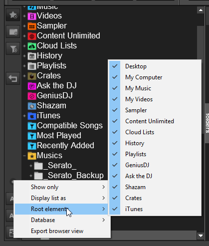

Is the Shazam folder selected from the Root Elements of the Browser Options menu ?
.. or is the folder visible but empty ?

That fixed the Shazam folder. Thank you! Now I'm signed in and refreshed but it's not showing anything in the window/display area for it.
