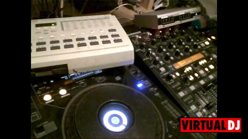

Hi, i'm trying to connect my Behringer DDM4000 + my Akai S20 with a midi hub M-box MIDISPORT 4x4, have all the mapping files but, connected to the hub all midi channels are mixed! thanks for helping!

Hi guys, things are moving forward here! i got the Akai s20 and the DDM4000 to work on the midisport 4x4 !
(BUT the DDM4000 is not receiving data for the LEDs)

virtual DJ did not see the DDM4000 when i added the (drivername="MIDISPORT 4x4 In A drivernameout="MIDISPORT 4x4 Out A" )
VDJ still displays the "Behringer DDM4000 V2" 5 times in the setup menu and none will "CONNECT" to the mixer for the LED display.
other problem is VDJ will not close, it will close the windows but continue to run as a process and and even prevent the laptop to shutdown

Hi everyone, I downloaded VDJ 7 and all controllers work perfectly LEDs on the DDM4000 lights are all on etc....with VDJ 7.. on the other hand VDJ 8 sees only the Akai with the right mapping, the DDM400 is not defined but VDJ8 sees it.
the last problem I'm facing now is that when I want to close either VDJ 7 or 8 it freezes and even if the software appear to close they remain working in the background. but if I disconnect the hub before I close VDJ 7 or 8 they will close normally.
so.. VDJ 7 sees both MIDI devices but won't close.
VDJ 8 only see the Akai 's mapping only and won't close.
Thanks for any help to solve the closing problem.
