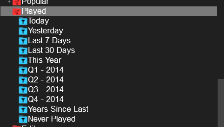

just have a look at the "my libary " tool in the download area.
this tool offers a lot of various filter folders. Also the one“s that might fit your needs.
If you just want a script for the currently played use :
exists = 1 and days since last play < 1
