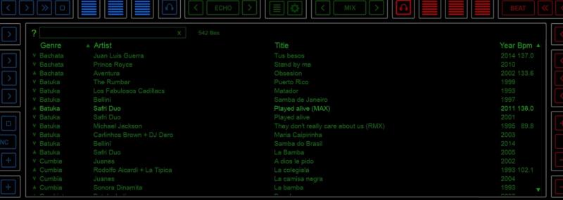

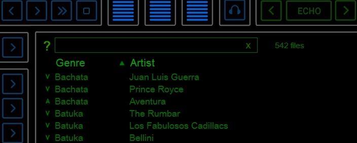

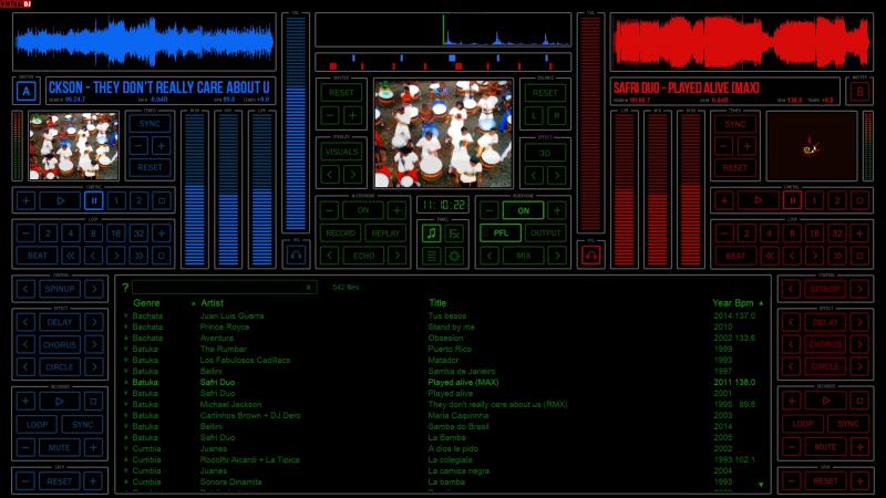

My "custom" browser ;)
Done with: customicons, and with : toolbars background, iconbackground and border in the browser section.
