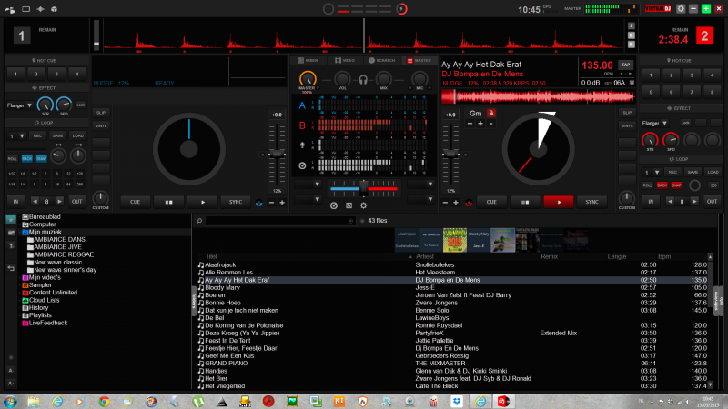

At the last update of 2162.953 there is an error at disk 2 a white square appears instead of the Red round.
Posted Fri 13 Mar 15 @ 4:48 am
This bug is specific to Fruit's skin and he's working to fix it...
Posted Fri 13 Mar 15 @ 9:10 am
