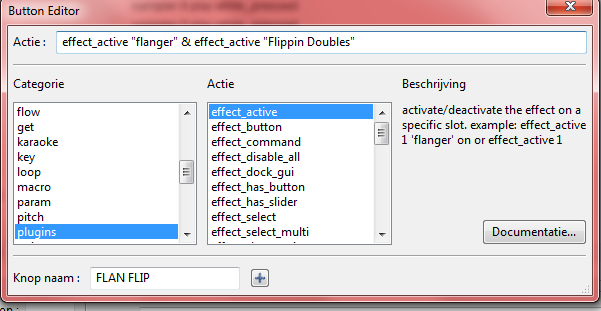

I am trying to map a few Custom buttons in VDJ8... So far so good.
If I press the button with my mouse, everything works (on both decks)
If I try to map the Custom button from deck 1 to a key on my keyboard it works, but if I map the other Custom button from deck 2 to another key on keyboard, it still keeps activating the button on deck 1
Custom.png" class="bb-img">
What am I missing?
Is there anyone who can point me in the right direction?
Kind Regards,
Stievie
EDIT: If theres only a song on deck 1 and no song on deck 3, the button(s) I assigned, triggers the Custom button on deck 1, if there's a song on both decks, the button(s) triggers deck 2... Think I forget a little piece of syntax somewhere....

The Custom_buttons are tied to a deck via the skin, so you shouldn't need to specify a deck,
but... it can't hurt to specify try add
deck X & effect_active 'FXname'
Flipping doubles works with V8??

So simple, it worked...
I knew I forgot a piece of syntax :)
Thank You!

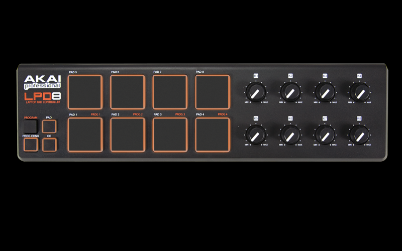

I'm trying to map an LPD8 for VDJ, I don't have problems with the buttons, they now do what I assigned them to do.
My problem is with the knobs.
I would like to map the knobs like the knobs on my controller... For example changing the filter.
But if I use key learn and turn a knob, I get three possibilities: jog1, encoder1, slider1
I think I need to assign slider1, but then I get stuck in the syntax.
In other words: I don't know what I have to do to make this knob change a certain effect (length, resonance,...)
I'm new to mapping, but I want to learn and I hope somebody can help me with this.

For those of you who don't know how the LPD8 looks like...
PADS:
I have 4 effects on the left for the left deck and 4 effects on the right for the right deck
KNOBS:
I would like to use the 4 knobs on the left to change the 4 pads on the left and 4 knobs on the right to change the 4 pads on the right.
PADS:
KNOBS:
