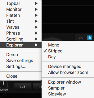

When type in song or artist in search it also switches to browser mode
Hi Bogart,
I had this happen to me when I updated the skin but would return to standard view after a couple of seconds of inactivity, I found the option in the top left corner.
Under Explorer make sure "device managed" & "allow browser zoom" are unchecked.
Posted Sun 30 Jul 17 @ 9:36 pm
bogartPRO InfinityMember since 2004
Seems to be the problem. Don't know how that happened.
THanks

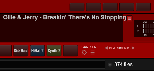

In the Extended Browser view, the text on the left deck is scrolling over the centre area.
