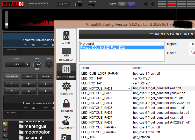

Exactly now works with that build and led the sx2 except the hot cue but I change them and let them figure if anyone is interested .

Good morning . When there will be full support for the Pioneer SX2 driver, even some things that do not work since leaving the update while in 2028,862 2028,853 and works well but they did an update and leave to grab .
What say something more if the controller controls up and another half were gone and so it the Picth this and was detected as the driver, are details that were already a day but stopped reading other stuff.
