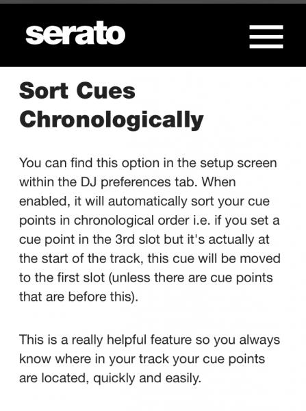

I'd like to have the option that VDJ automatically sort cue in a songs in chronological order, like its possible in Serato.
I'm sure that's an option that's been there since pre 8.1 days,
I'll check once at my machine.
