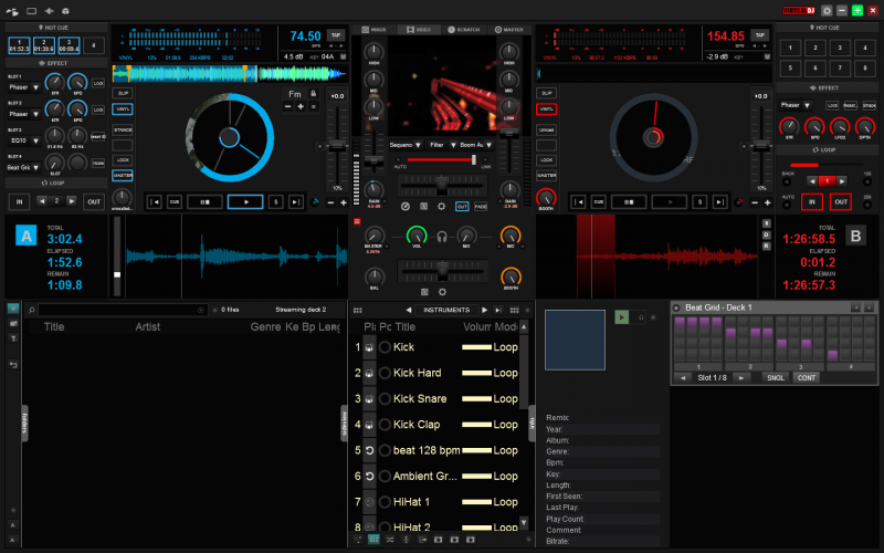

First of all Fruit, thanks for the skin. It's all you could ever want in a skin. My question is about the "save" option. What exactly gets retained when you "save." I make a lot of customizations and it seems like when I start the program I have to re-select some options. Thanks in advance... really appreciate the work!!!
This item's purpose is to write the vdj options in settings.xml, what is actually done when you close the software only. I use it because I sometimes crash when working on my skin. I let it here in case it could be usefull to others.
Most of the states of the skin will remain when closing/opening the software, with a few exceptions. Those exceptions were a choice of me, for example, I don't want users to start the program and not see the title/artist and be forced to search what option they triggered last night when they were drunk (lol).
But some of them will anyway remain in 0.5, mainly, the vu-meters color, the cover if on wheel, key info in deck's screen.
Posted Sat 02 Aug 14 @ 5:25 pm

So I'm at home now and just checked :
As I said at the very first launch there are no icons.
As soon as you check one of the items 'show music', 'show video', or 'show karaoke', buttons will appear.
They will remain until you :
- uncheck all three items
- close / relaunch vdj
Then they will pop up again once you check one item.
Each browser has its own properties / states so the above is to be considered for EVERY browser of my skin.

I can easily make those 'show' buttons disappear.
First of all, I always have 'show music' selected so I would always expect to see the buttons - yes?
All I have to do to make them disappear is select the double height waveform (which forces the browser to be lower). The buttons are gone.
I still have 'show music' selected. I can restart and the buttons are still missing.
Believe me, I have seen the buttons disappear right in front of my eyes when I resize a skin or use one which has a small browser height.
I have also seen the buttons being displayed one on top of the other when the browser is small.

I have a 1440x900 16:10 rez at home.
Not exactly a 16:9 ratio but close.
But I found someone who has a 1920x1080 screen I'll check there to be sure, but it will be in two weeks...
Did you try to check an item WHILE you don't see the buttons (let's say in fullscreen mode) ?
I ask this because, imo this is a bug : the menu stills always show the same items checked, BUT checking one of them would make the buttons appear (but you're right if the window is too small they disappear, but the window has to be ridiculously small in height). Can you confirm ou infirm this please ?

Just installed .05, I cant get the pitch reset button to work, programming issue? or did I somehow disable it
Posted Wed 06 Aug 14 @ 9:24 am
beat me to it
Posted Wed 06 Aug 14 @ 9:50 am
OMG I forgot a line in changelog...
I changed the behavior of this button because I read that some guys don't want the doubleclick feature.
So, to instant-reset the pitch you now have to hold RIGHT for 2sec.
Erf and left click won't do anything now :( that's a bug :(
