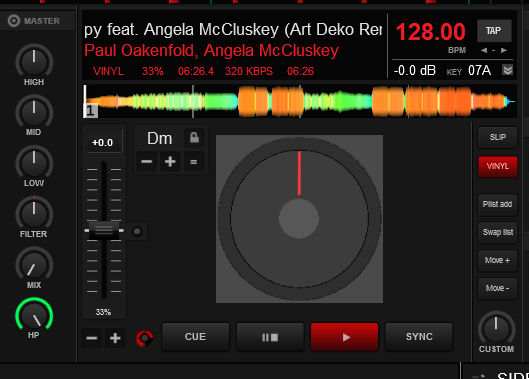

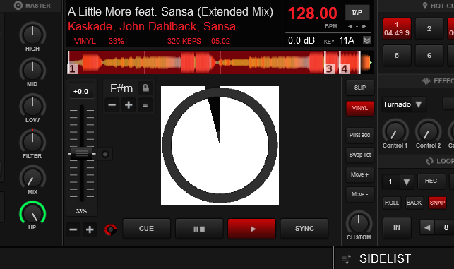

build 2162
started getting this on right deck 2 deck layout
not sure whats happening
maybe because they did this -> -Added support for mask to skin cover
also getting this when scratching with right deck

Same thing reported in the beta forum. Right deck only.
