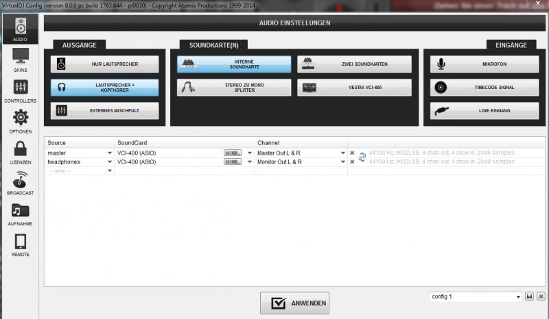

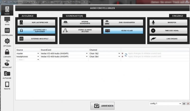

I'm using the Vestax VCI400 and just installed the actual drivers on my computer to test the new VDJ.
The software recognized immediately Vestax VCI-400 in the soundcards, but with a Wasapi driver.
As soon as I try to change this (as this driver doesn't work fine) to VCI-400 (Asio), the configuration jumps to either "Internal soundcards" or "2 soundcards" (sometimes to the one or the other).
Please take care of this problem because I can't use v8 if I can't choose the correct soundcard.
Ty
Paul

Vestax had unfortunately changed the drivername in the latest updated version (which btw is titled to work with Win8)
Anyways, we have updated the default files to use the new ASIO name. If for some reason someone has the old version, it will fall to Wasapi of course if click on the VCI button on the top, but could choose the driver from the list too and save his Audio Setup as a profile.
Fixed in builds ending at .645

Thanks Babis...all VCI 400 DJ´s will appreciate that.
So Braenzu was right, cause he suspected a "name issue" right from the beginning...
