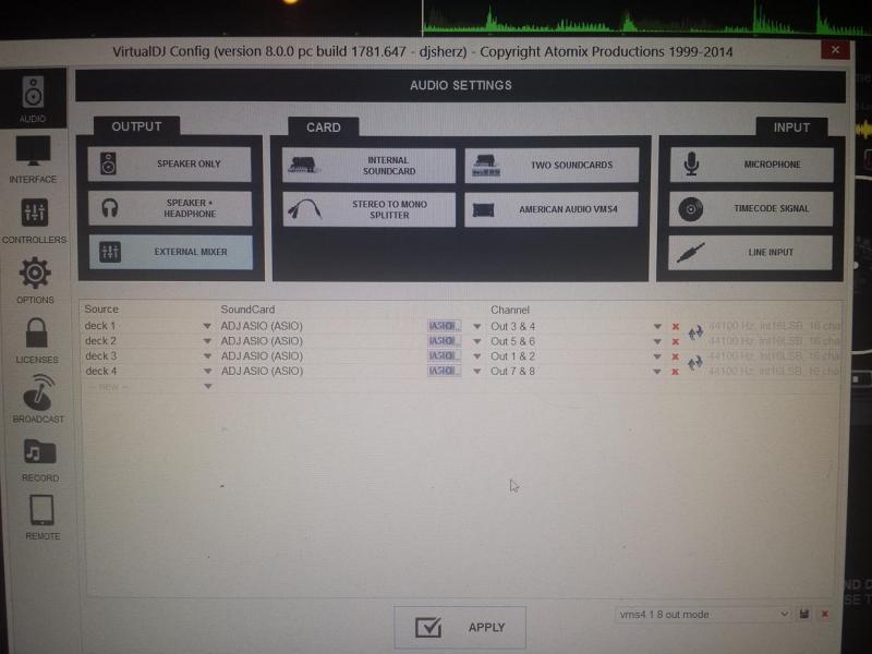

I'll fire my VMS4.1 up in a bit and have a play myself. I've currently got it in 4in/4out mode, using the onboard analogue mixer, and running timecode through it, and all's well. How have you guys got yours set up? I'll try and replicate the problem here.

Mines in 8 out mode.

OK, I'll try it in 8-out mode. In virtual dj, do you route master-and-headphones signals to it, or does each deck use a couple of channels of usb audio each?

No headphones are direct from vms. All 4 decks use 2 channels each.

OK got mine running in 4 deck mode, 4 decks running through 4 faders on my VMS4.1...
All 4 decks playing fine, although I've noticed your issue about the faders of VDJ's mixer - because I'm using an external mixer, it doesn't matter that the wrong fader/no fader moves on the screen, it doesn't affect the sound as these are just "fake" commands to get the screen to mirror what the mixer is doing. Probably just a small mapping issue. I'm loathed to fiddle with my mappings tonight though, as I'll be using this beast on a karaoke gig tomorrow night!

The issue with the missing fader is the bit you've circled on the left - faders 2,3, and 4 are called "VOLUME_1234", fader one is defined as " VOLUME_1234", with that extra space at the start. If you add a new line to the mapping to include " VOLUME_1234" using the same actions as the existing command line for "VOLUME_1234" you get all faders working, but in the wrong order. This must surely be an issue with the ONINIT command at the top of the mapping, which includes the line "mixer_order 3124", yet it still seems to follow the pattern of 1234.

Just in case anybody has been trying to do this - I've had a read of the manual and refreshed my memory, and I was wrong on this point - you can't send a master and headphones signal to this thing - it won't route the sound to the master and pfl circuits respectively, you can only route it to the mixer input channels. Which is a shame, as it means the VMS4.1 is effectively an external mixer, which means the Sandbox feature will be no good to us VMS4.1 users. :(
