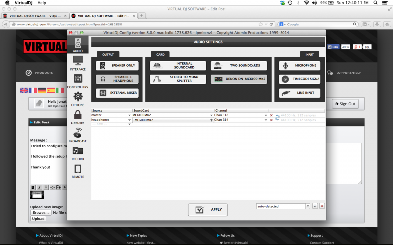

I tried to configure my controller in Virtual DJ 8 however I may have done something wrong.
I followed the setup I had in 7 but maybe someone can tell me what I am doing wrong.

Which controller?
Posted Sun 11 May 14 @ 11:39 am
Which controller ?
Posted Sun 11 May 14 @ 11:40 am
Judging by the screen shot its MC-6000mk2

Those settings look correct. What is the issue with the 6000 MK2? No sound? No control?
Posted Sun 11 May 14 @ 11:42 am
On built in output try to use ch1+2 instead of 3+4
Normally though you should just press the MC6000 button and the sound will auto-configure
I can only control the volume; nothing else. I will try and report back.
Posted Sun 11 May 14 @ 1:42 pm
The built in was channel was the problem so that issue is fixed. However, i had the next issue in Virtual 7 regarding cross fading. The cross fade feature does not work and it's a PITA to configure. Right now I cannot fade between Deck's 1 & 2. Both "Cue" lights on the mixer are on and both songs are playing out of monitors. Launching 7, I have no issue what so ever and I do not know how I fixed it. I just kept messing around with it until it worked right. LOL

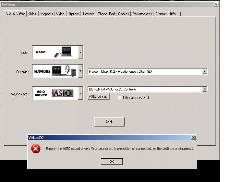

I am having a problem with this. My setup is as pictured above, only the Denon ASIO Card is selected and not the MK2. Upon opening VDJ, I get a windows error message that says that asio buffers were not created. There is no sound or control from the mk 2.
Posted Wed 09 Jul 14 @ 11:10 am
Have you installed the DEnon ASIO fro Controllers ?
Is that specific ASIO available in the drop down list of Sound cards ?
What happens when u click on the ASIO small button next to the Denon ASIO ?
Can you post screenshots of both the Denon ASIO panel and the Audio Setup of VirtualDJ with the error you receive ?
Posted Wed 09 Jul 14 @ 1:00 pm

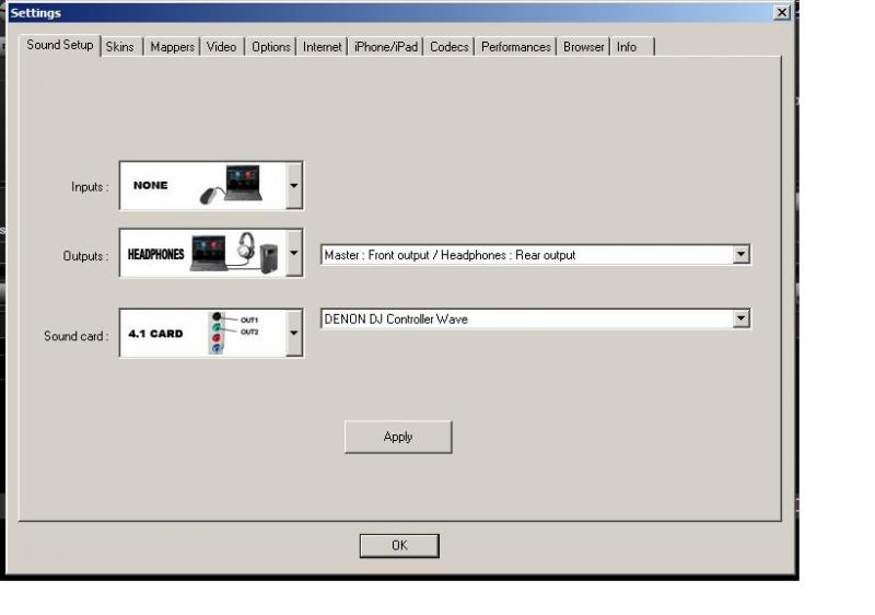

This is what happens when trying to setup ASIO on an xPro os. V7.4
Only way I could make it work.

Well, this is a forum for version 8 actually. I would rather prefer to post in the other forums if you have issues only with version 7.
If the issue is present with version 8 as well, then Ok.
It appears that the ASIO drivers are not available. This means probably not installed properly.
Try to do that again.
If you click on the [ASIO Config] button, does the ASIO Denon Control panel appear ? Can you post a screenshot of that ?
Posted Wed 09 Jul 14 @ 3:17 pm
No it doesn't appear and get the same error, but it does work under Win 7Pro os properly.. Haven't tried v8. Will have to get another computer set up for v8 because its giving me issue with v7 in the same computer, so will check then in v8..
