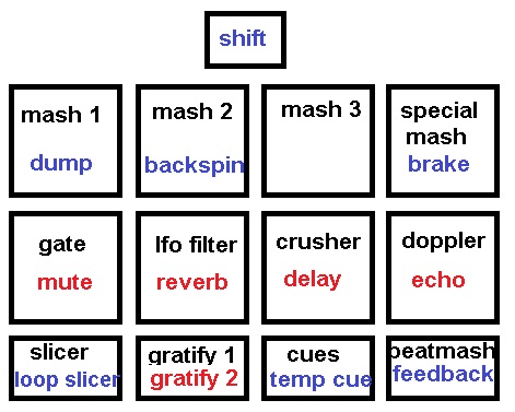

Hey JB,
so far I have the grid set out as follows, want to know if you had any suggestions or concerns about the settings. It will basically have 8 different settings, the black is if you hit the button the blue and gratify 2 is if you are holding shift. then the red in the grid is the second gratify setting, the masher will remain on both settings.
it will have Duen - Duens slicer effects, upcoming feedback loop, beatmasher_single.
The cues have 2 settings, normal where it is a hotcue and temporary that only cues while you press the button, then you will need to hit play to continue playing the track

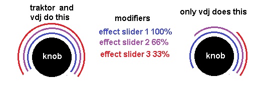

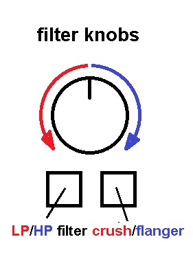

          I have also done this for the filter knobs, what do you think about that?
finally I am not sure what to do about the effect knobs, ideally I would want to emulate the chained and advanced effects like in traktor, however without a dedicated skin it wouldn't be that intuative, although I could change the led settings so all are on when in advanced effect mode and you would just need to know it will only effect slot 1, the other option I am more inclined to use is just have 6 effect individual knobs, probably using the standard effects
wouldn't have a clue what to use the encoder for if setting it up like this, but maybe when vdj8 drops the interface will change...
- gate/trans
 - white noise/my built knob "white noise and roll"
 - beatmasher/gate

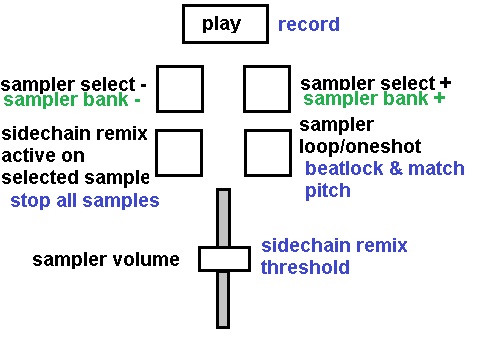

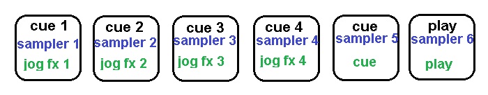

          I want this to have 2 different ways to access the sampler first is the sampler section in the middle of the controller, second is the velocity sensitive pads down the bottom
the idea is that you can trigger 1 sample at a time, but you can scroll through all 12 samples
features-
with the velocity sensitive pads it has three banks so will be used for basic transport, samples and jog fx modes.
features-
- sampler select scroll backwards and forwards
 - sampler bank scroll, this you would need to modify to suit the samples you use, its is as easy as downloading the sampler manager plugin, setting your sampler banks. Then go into the Samplermanager.ini file where you will see all the filepaths for your sample banks, just enter those into the mapping, It will be harder to change than using the sample manager plugin, but I want to remove the mouse from the equation. and using "cycle" you can have as many banks as you want, you could even program the action of the sampler play button with the different banks.
 - sidechain remix - Duen Duen's great new plugin that triggers the sample when the track volume drops below a certain threshold, you can also adjust the threshhold with shift and the sample volume knob.
 - stop all samples
 - sample loop/oneshot, will change the behavior of the sampler play button for the selected sample, hold to change all sample banks
 - sampler match pitch/beatlock - will change the selected sample from oneshot to beatlocked and pitch locked, hold to change for all samples
- transport - hotcues, play, cue
 - samples
-sampler play
-sampler play with velocity sensitive sampler volume, for some drumming.
-shift for oneshot/loop - jog fx
-filter
-granulizer
-something I'll think of
-rollit

          Hey synthet1c,
That looks very action packed!
On the grid:
The shift:
When you press shift, the whole grid stays shifted and lights up brighter. So its a holding shift. I have kind of a wild idea with a third state. But thats further down.
Looping control:
In the original mapping its the loop and sample control. Sample is kinda double with the one on the transport bar, same is the loop with the knobs above, but I do miss the quick access to loop 1/4, 1, 4, 8, 16 straight from a button without presetting it and looking at a screen.
Brake & Backspin:
I've mapped the brake and backspin in the transport bar. Actually I didn't do the backspin since you can do that manually with the jogwheels, what I mapped was an attempt to stop with a reverb.
Filter knob
The idea to have multiple effects options there is great. Most logical place to have that control.
The two buttons under the filters are normally mapped for cross fader side selection. I've added the enabling of the autostart as well. When mixing with four decks and the cross fader I find this extremely handy, so I wouldn't drop that for effect selection.

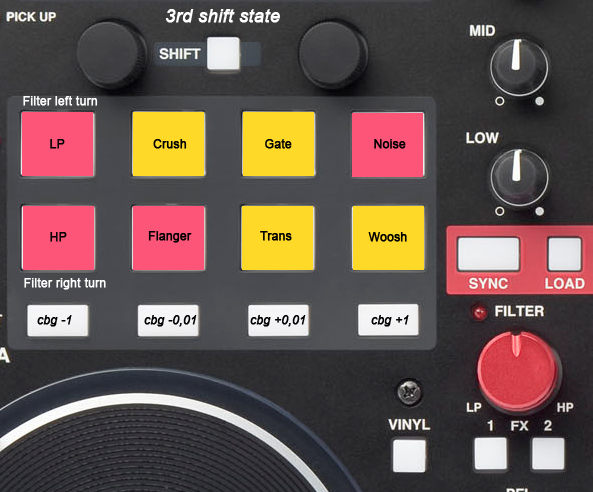

But how about this wild idea:
Make a third shift state for the grid aka a third page, either by pressing the shift button again or by long press. The grid will now blink. the upper four of the grid are effect on/off for the left side of the filter knob. The middle four of the grid for the right side of the knob. When an effect is enabled it will light up in the inverted color of the grid (grid buttons can be yellow or red depending on the choice of deck. That way you can chain four effects to the left and four effects to the right side of the filter knob and control the chain with the grid.
The third state could also be used for grid manipulation. I've mapped the smaller buttons to grid changes.
Sampler
I love using the video part for sample play, even though it would be nice to be able to switch back to the video configuration.

          On the Grid
the way I map the loop section of my dj3 is just a button to activate the loop, and a knob to change the size, the trick with it is when deactivating the loop it sets the size as 8, so no matter what I know the size will start at 8, then I just feel the encoder clicks to know what size the loop is, to me everything else is unnessecary, but I can kill the (beatmasher/feedback) shift and make that control the loop and something else, that would give you
loop in, loop out, loop 4, loop 8
hotloop 1, hotloop 2, hotloop 3, hotloop 4
or anything else you would prefer.
For the cbg I was thinking of using the loop size encoder on the top right of the grid, when normal it just changes the loop size, but when shifted finely adjusts the cbj, if you are holding shift and press the encoder in it will change the grid by 25%, the grid is something that only gets used once per track, so imo not a good idea to permanant buttons, but let me know if you want it your way, I try and find another button to shift
with the Brake & Backspin that is just what the masher buttons do when you hit the "special mash" button, they are just the action when pressing shift, they can be anything though..
Filter knob
for this I can make the buttons crossfader select normally and filter knob effect under shift, so you get the best of both worlds.
for the third state idea I can just make that the second gratify shift and scrap the one on there, but I need to know what settings you want to make it work, eg buttons and sliders.
for the HP/LP, noise, woosh, buttons unfortunately that won't currently work as there is a problem with the "repeat" verb so it would have to wait until vdj8 if it gets fixed. at the moment you can only have specific settings eg "down ? 70% : (up) 0%".
Also gate and trans I was going to include on one of the three knobs up the top, so you can change the gate threshold or the trans wet/dry on the fly, you could also use the effect encoder if pressing the gate/trans button to change the size of the cut. The idea of mute is so you can kill the input to an echo or delay and let it fade out.
Sampler
setting that for video fx/sampler shouldn't be a problem, I will make it so if you press both the sampler backwards and forwards buttons together you change between sampler and video fx.

Filter knob
