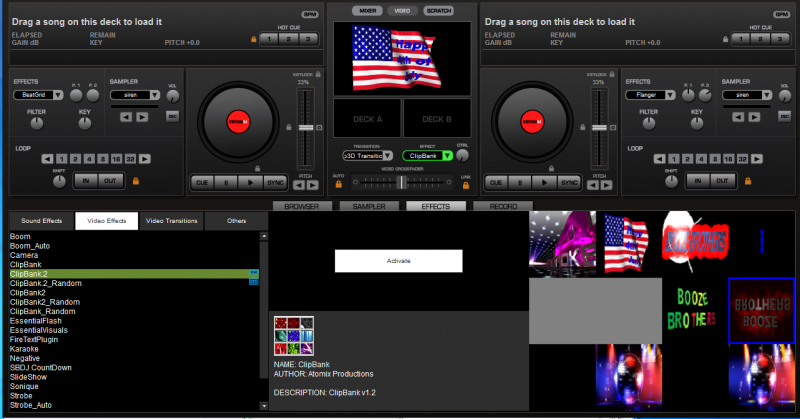

Has anything changed in version 7 for duplicating clip banks? In version 5.xx, I had multiple clipbanks... maybe 12 or 15 total. I just copied the standard clipbank DLL and renamed it, and then re-loaded it with new clips. The DLL would then generate the BMP file to match the DLL name.
But now I am rebuilding my banks in Version 7, and when I copy the DLL and rename it and reload it, the bitmap that is created remains as clipbank.bmp - no matter what the DLL is named. That means that every clipbank I create has the same thumbnail selection preview box.
Am I doing something wrong?

That's exactly my point... I want to prep them before the show.
But version 7 does not allow you to create more than 1 clipbank like version 5 did. But DJ Soulman seems to have found a way.

Yes that is exactly the procedure I am doing. But everytime I paste the group of 3 files back into video effects folder And then select one of the clipbanks, the system proceeds to write a new the bmp file for that clipbank called clipbank.bmp. So while I have clipbank1.dll, clipbank 2.dll clipbank3.dll,etc.... they all generate only one bmp file called clipbank.bmp. therefore they all show the exact same preview box.
And yes... I do get greyed out boxes for some files.

OK gentlemen, this is what I just did. I downloaded 7.04 to my office machine, so I have a fresh copy. I opened the video effects folder, and there was only one clipbank.dll file. I made a new folder calling it new clipbanks. I copied the clipbank.dll file and put it in the new clipbank folder, twice. I renamed these files clipbank2.dll, and clipbank3.dll. I then copied these two files and put them into the video effects folder. I closed VDJ, just to be on the safe side, and reopened. All three banks were listed in the video effects menu. I put one clip into each bank. they opened just fine. I was even able to play all at the same time, without deactivating the previous clip. They just opened on top of the previous one. Thanks guys for making this easy enough so even I could understand. Can I now get rid of the that new clipbank folder?
My question now is, why do I have so many files on my gig machine? There is a clipbank.dll, .ini, and .bmp in the video effects folder on my gig machine, yet there is only one clipbank.dll on the version I just downloaded.
