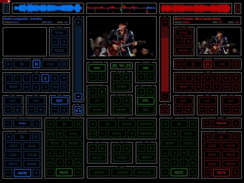

DJ Corny presents... the ULTIMATE TOUCH SCREEN SKIN for Virtual DJ! Tataaa...(crowd's going loco)
Alright, here's my third (and final!) version of the TOUCH SCREEN SKIN I have designed:
It looks the same as the second installment, but it isn't. I have (finally) achieved to make pannels (yes, with browsers, and yes, without glitches or refreshing trouble!) and that was the solution I was aiming for. So here's what we have:
FULL SCREEN CONTROLS PANNEL (the one you work with during a gig)
FULL SCREEN BROWSER PANNEL (with BIG scrolling, preview and load buttons)
FULL SCREEN SETTINGS PANNEL (to adjust the software just the way you like it)
The only thing I'm not 100% satisfied about is that the skin supposes that you have your music in C:\MUSIC and your samples in C:\SAMPLES. I needed to do it this way to make buttons for quick and clean browser access...
There are 2 decks for playing video/audio, 2 decks that are used as samplers (with PFL, EQ, beatmatch, sync, pitchlock, etc.), 2 "live" sample/loop recorders (the original samplers from Virtual DJ), and 1 microphone "deck" (line in) with volume, EQ and FX control.

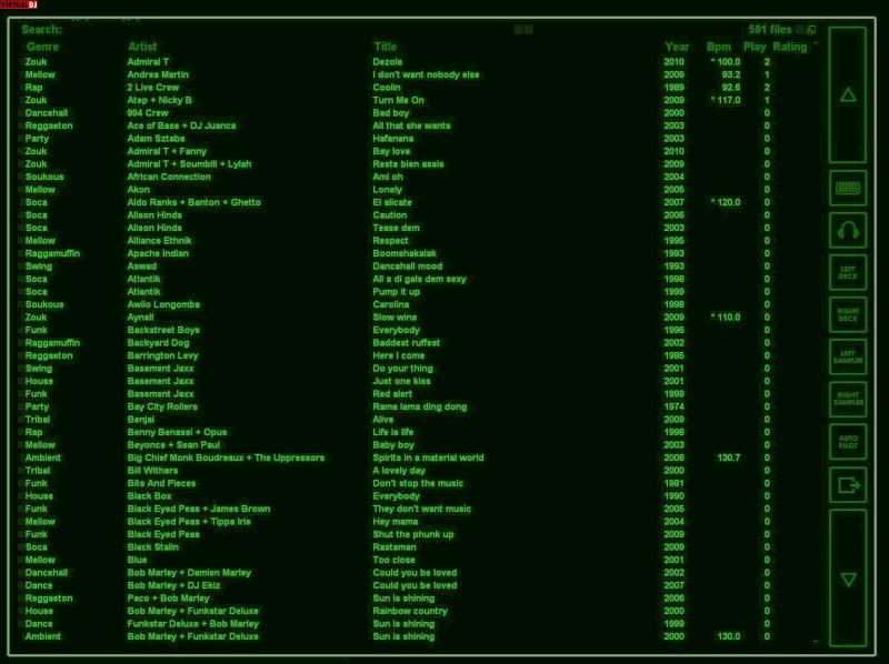

This is the browser pannel looks like:

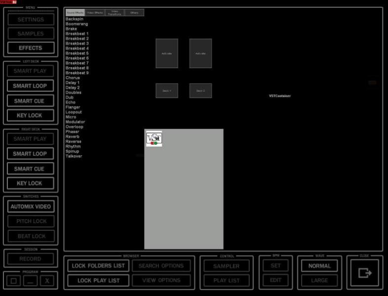

And this is the configuration pannel:

Your browser is only visible when the "music" button is pushed. It will then zoom up and occupy the whole screen. In my former skin the browser area was rather limited. Now you have plenty of space to browse in! With nice, big, touch screen friendly, scroll buttons. The music data is assumed to be in c:\music. so you either have to put all your music there or modify the xml file and put in the correct route for your system, or simply erase the directional part. You can navigate to the right folder with the two-pane browser anyway.
