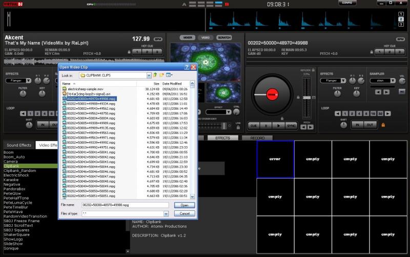

i need help with the clip bank.
it doesn't load clips on it.
the clips are avi or mpeg and they load to the decks but in the clipbank tablet it shows error when i try to load them.
this clips were used before on vdj 5 i used to play with and they worked just fine.

ok guys solved the problem !!!!!!!!!!!!!!!!
first of all thanks to babis who tiped me with the problem he thought i had.
the solution to my problem was changing the path of the file from hebrew names to english.
i did just that and the clipbank came alive from the dead.
not just the files need to be in english or numeric names but also the path to the file needs to be in english.
the couse that it worked just fine on the 5 ver and on the newer vers it didnt was because the newer vertion dont fully support the hebrew lang.
i was chating with bob from the support and he said they'll do there best to fix the support for hebrew lang.
thanks for all your help and thanks to all the supporters in vdj chat line.
all of you are great.
warm greetings from israel
yoram levy
maestro music
