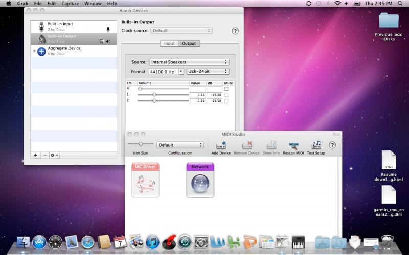

Yesterday, I tried again. When I opened up the Audio Midi set-up (followed my the Midi window), this is what I see:
. Clearly, this does not resemble the screen illustrated on the Denon website as there are no external sound card options.
Now, the HD 2500 knows that it is connected to a computer because it allows me to go into Midi mode. But, the MBP does not recognize the HD-2500 I unplugged and re-plugged the USB cable, I restarted both the 2500 and the MBP, and I rescanned for midi components, all with no luck.

The problem may be in the midi controller naming. If the name is not done properly, then the controller won't be recognized. I would go to Denon's website and look at the mac midi configuration page. If you are still having problems, then call Denon while you are sitting in front of your MBP and Denon controller and it will probably be a 5 minute phone call.
I looked at your screen shot and didn't even see the Denon controller in your midi devices.
