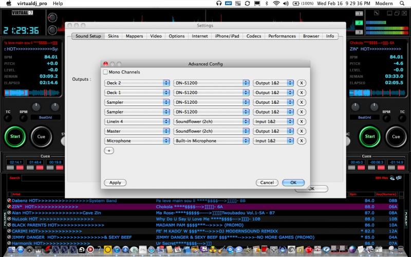

3. Open Virtual DJ Pro 7 and go to Outputs Advance config. add those audio channels like in this pic
4. You only 2 channels for the two denon DN-S1200s. Adding the rest of the channels are optional.
5. Go to Mapper Options and set deck 1 to DN-S100 1 and Deck 2 to DN-S1200 2

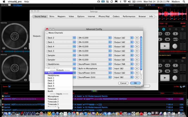

A little bonus. Pic of the audio Advance coonfig for 4 decks:
