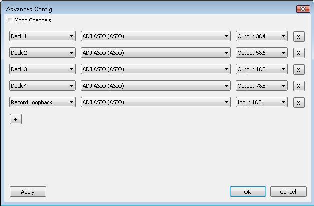

Sto deck 3 den tha exeis giati twra einai se input mode gia na mporeis na ixografeis. Gia to deck 4 vale sto sound setup
Deck 4 .. ADJ ASIO .... output 7&8

Loipon ..eixa kanei lathos..sxetika me to record, to booth, ta rca kai to recording genika gia tin karta ixou tis VMS4. Ta pragmata einai arketa mperdemena kai to manual den boithaei.
Akouste pws exoun ta pragmata,
Katarxin i konsola exei san karta ixou 2 modes, to 8out modekai to 4out mode Auto pou ousiastika ennoei einai posa kanalia tha elegxei to software.
8outmode
An dld valeis tin konsola sto 8out mode tote mporeis na gyriseis ola ta ch se USB kai sto soundsetup na dwseis Deck 1..ws Deck 4.. stis antistoixes out1&2, out 3&4,klp...
Twra ti ginetai me tis eisodous sto 8out. Ousiastika yparxei mono mia i input 1&2 opws tin onomazei kai den yparxei tropos na tin antistoixiseis sto pisw meros. Einai to internal linein pou xrisimopoiei to software wste na kanei tin ixografisi.
Ara an thes na kaneis record vazeis RecordLoopback input 1&2, kai den syndeeis tipota apo pisw. Hxografei kai to mikrofwno me auton ton tropo. Omologw pws mou ekane stin arxi paramorfwsi, me auto to setup otan to epeleksa gia ptwti fora, alla otan ekleisa kai ksananoiksa to Virtual, estrwse o ixos.
Episis na anaferw kai na aposafinisw kati. Mporeite na exete syndedemena osa cdplayers thelete sto pisw meros tis VMS4, akoma kai 4. O ixos pou tha pernete tha synexisei na einai o ixos tou VirtualDJ me ta 4 decks kanonika.Den allazei tipota. Ana pasa stigmi theleisete na gyrisete se ena CDplayer apla gyrnate opoio kanali thelete apo mprosta sto Analogue. To virtualDJ tha synexizei na paizei to deck alla ta akougetai i ekswteriki pigi stin eksodo. Ta ypoloipa decks fysika tou VirtualDJ tha synexizoun na akougontai. Mono auto pou gyrisate den tha yparxei stin eksodo.
Me liga logia mporeite na exete 8 decks stin VMS4. 4 Decks me to VirtualDJ kai 4 analogika Decks (oxi timecodes).

To sound setup gia record me 4 decks einai auto.. Den xreiazetai na syndeseis tipota apo pisw. To mikrofwno ixografeitai kanonika.
Apla pas sto REc apo to config kai patas Start.
