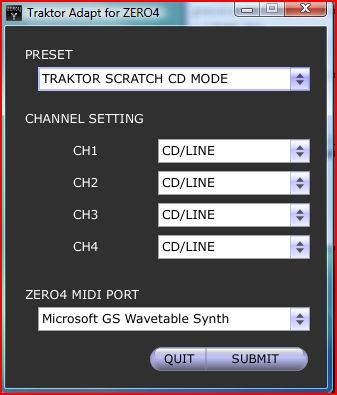

Go to Korg support download page:
http://korg.com/SupportResults.aspx?productid=281
Scroll down to the bottom, dowload \\\\\\\"Using the ZERO4 w/Traktor Scratch Pro / TraktorAdaptForZERO4_v1.0.0_EN.zip\\\\\\\"
Or
Download this link (easiest): http://korg.com/uploads/Download/TraktorAdaptForZERO4_v1.0.0_EN_633707428404970000.zip
It is a tool that will toggle the Zero4 to listen to the the CD audio ports instead of the Turntable ports. Unzip the file.

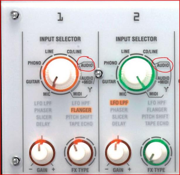

Plug in the CD players to channels 1 and 2, switch the Audio inputs to Audio or Audio+Midi if you want to use the black effect knobs for midi control.
Do not use CD/Line- you will only be able to hear the timecode sound, not the output of the internal sound card.
Open the Tracktor adapter, set to CD player time code:
Using Ch 3 and 4 for timecode mixing is not supported in VDJ.
