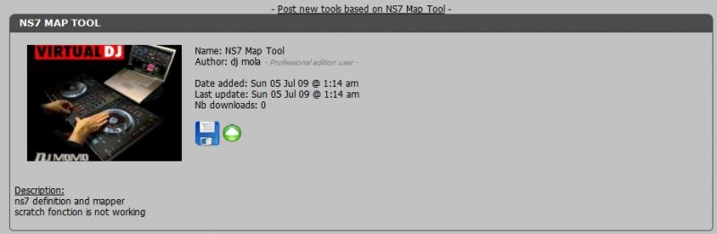

I have just upload the map of the NS7 on vdj tools with using your link !
NS7.jpg" class="bb-img">
thanks
thanks
Posted Sat 04 Jul 09 @ 6:20 pm
