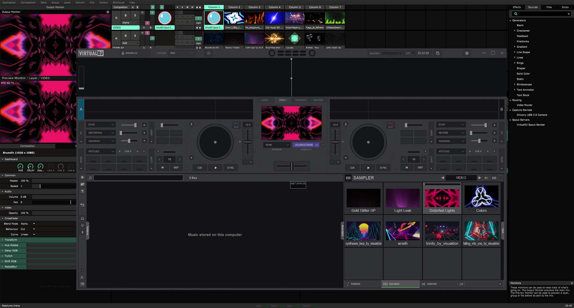

In previous versions of VDJ when I was using the "VDJSpoutSender" plugin all I had to do was select "preview only" and activate the plugin and the video was sent in 1080p resolution to Resolume. In the current version this no longer happens, when I select "preview only" the resolution that is sent by the plugin to Resolume is the preview resolution of the VDJ.
For a better understanding, I recorded a video of the problem:
times:
00:00 -> 00:31 I show that I have a video sampler running and the "VDJSpoutSender" is activated, in resolume the plugin is active and working normally at the resolution of 1920x1080
00:31 -> 00:53 i click with the right button and the output is set to fullscreen, so I click on "Preview Only" and return to Resolume and now the plugin has the resolution of 426x240 and this makes the video resizes to a really small block on the center of the screen. (the output resolution on Resolume is 1920x1080, we have 6 TVs and 1 projector at the club that run on this resolution)
My wish is to have a option in settings to set the resolution of the "preview" or revert to whats was before: set the preview and the video still has 1920x1080 on the spout sender.
