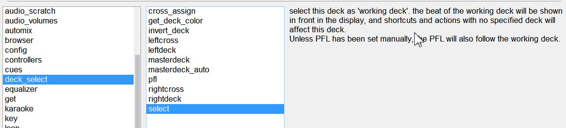

((((, and shortcuts and actions with no specified deck will affect this deck )))))
And this is not the case with me.
If I select deck 2 as working deck, then the controller (Beatstep or Icon) will continue to control deck 1 ...
There is the mistake.
Greetings Dani

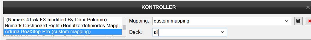

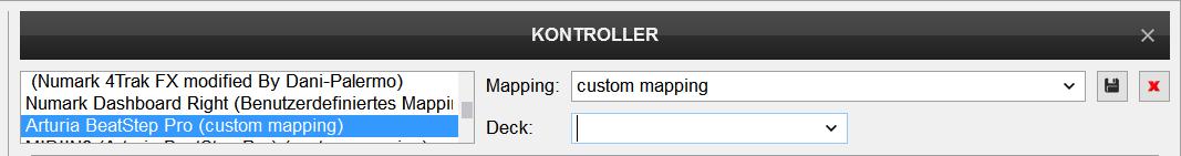

Hello.
I think I found the mistake.
If I type in the Controller Mapper, as shown in the screenshot above, on decks "All" or "default", then it suddenly works.
If I then select another deck as the default deck then for him on this deck the command ....
but Virtual DJ does not seem to remember that or save it.
Because if I close Virtual DJ, and open it again, this field (decks) will be empty again ..
Here as on the 2nd screenshot after reopening the program ..
And then it does not work anymore ...
That must be it.
But as already written, the error only occurs with controllers in Simple-Midi mapping.
Greetings Dani

Unfortunately, this bug is still present in the new update.
All controllers that run in the Simple Midi do not recognize the default deck .. Just as in the post above, but it does not stay after restarting Virtual DJ !!!
Greetings Dani
Posted Tue 05 Mar 19 @ 4:35 pm
Thanks .
Now it works again , and saves the Setting for Simple Midi Controllers ;-)
Greetings Dani
Posted Tue 09 Apr 19 @ 1:23 pm
