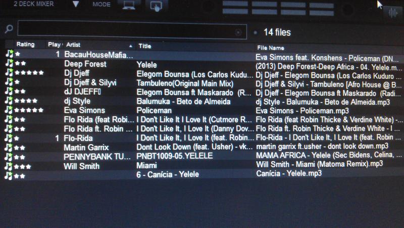

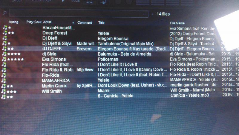

So once again here's what I do:
2 laptops.
i do my ratings on the first.... then transfer files to the other...
select folder and batch reload all tags.
half of my star ratings aren't there!
pictures included and folder in a seperate Wetransfer mail..
Please fix this as I'm not interested in using the Database sync method.. and I want to actually be able to write ID3 tags stars correctly from within VDJ 8
oh by the way:::: when I do it from within explorer (right click / properties / change star rating / apply ) then it reads all the tags like it should!
build 2325.995

Posted Tue 16 Jun 15 @ 4:38 pm
I mailed the entire folder to Adion via a wetransfer. Please guys

Thanks for sending the files. I had some time to look at them now, and found 2 problems preventing the tags to be written correctly.
The first was that some files were tagged using a very old and not commonly used version of ID3, namely ID3v2.2
VDJ doesn't support writing ID3v2.2, so this will be fixed by converting ID3v2.2 tags to ID3v2.3 tags when you try to write the tag.
The second problem found was that for some mp3 tags, VDJ was not able to increase the size of the tag, so if there was not enough room to write extra information tag writing would fail. This will also be fixed, making all the files you sent write the rating correctly from within vdj.
These fixes will be available in one of the next updates.
