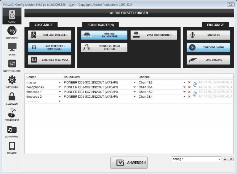

After launching Serato DJ and DVS Plugin the drivers are only changed for WASAPI mode of the DDJ-SX2. I can't access the ASIO Settings anymore.
So ASIO4ALL is for me the way to play with only 1ms latency and i think it has improved since version 2.
Of course it works also with WASAPI Mode alone without ASIO4ALL but the latency is not that good, the feeling is more loose on the TTs.
Here are my Settings:
DDJ-SX2 with the standard driver:
DDJ-SX2 2In2Out in WASAPI Mode
DDJ-SX2 2In2Out with ASIO4ALL v2
How can i access the DDJ-SX2 in 2In2Out Mode as a Midi-Controller?

user14854760 wrote :
IT NO POSSIBLE
Yes it is possible. I have an SX2 and use it with VDJ 8. It's a natively supported controller.
Of course you will need to buy a license.
