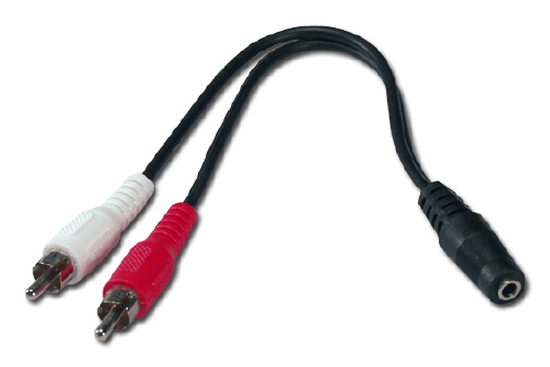

The cable #11 has one end going to the sub (Audio Input), and the other end, the one you normally connect to your PC, needs to be connected to Output 1-2 (Boot Out 1-2) of the Rmx2. For this, you will certainly need an adapter, or a replacement mini-jack to RCA cable:
DO NOT connect the speakers directly to the Rmx2. There are meant to be connected to the subwoofer to get to necessary power.

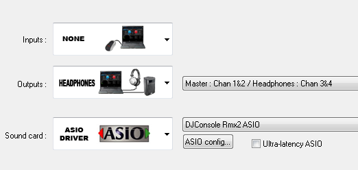

As for the audio configuration of VDJ, it should be as follow:
