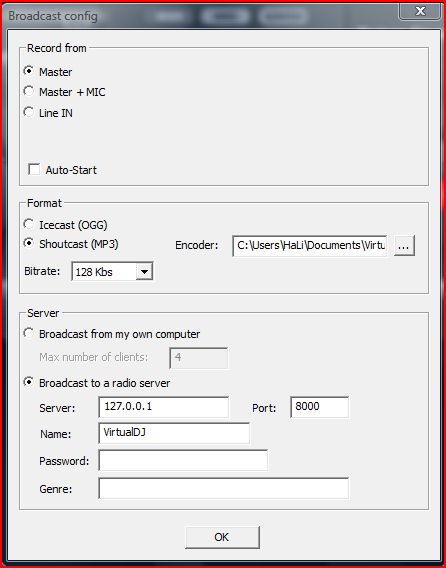

I didn't wrote YOU stream to VDJ Radio, i say I do it very often without ANY problems and a lot of DJ's too!
We stream also to a server and so in the same way like you!
So i belive it is a encoder or setting failure.
Did you have the settings like that?

Yes, my settings are like yours. But I record from "Master+mic".
I have solved the problem today. I uninstalled VDJ and cleaned "windows registry" with another tool (not the same that I used the first time), then I reinstalled VDJ, reconfigure the server and ĄĄworks OK!! I donīt know the reason, but 2 hours of live session and no problem. Maybe this is a "computer mistery". Thanks for trying to help.
