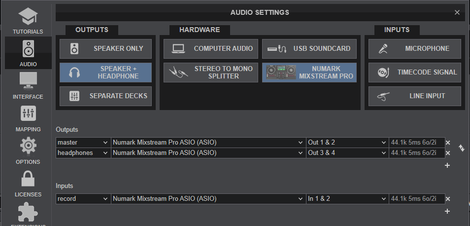

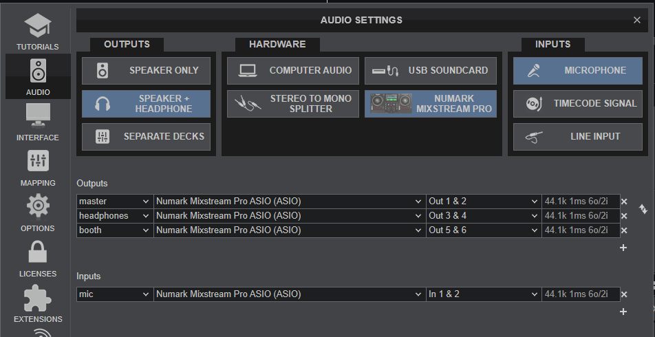

AUDIO Setup
The unit has a pre-defined Audio setup and a special button in the AUDIO tab of VirtualDJ Settings to provide that.
See also Inputs & Recording.
For further software settings please refer to the User Guide of VirtualDJ.
