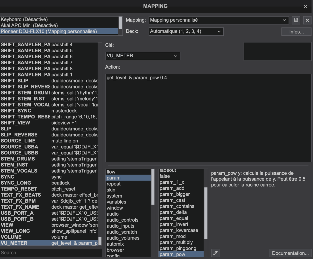

Hi,
The Vu-meter have a scale to low.... not like Rekordbox. (Rekordbox it's 3 DBFS per light, not 1 dBfs per light...)
so i've found a fix :
<map value="VU_METER" action="get_level & param_pow 0.4 " />
i add param_pow 0.4
-> great FLX10 meter display more like Rekordbox scale......
and still max - 1 DBFS value, last light to avoid clip. (I check with calibrated dBfs 1000 Hz test tone, with auto gain disable, and different headroom (zero dB option)
Please add this in default FLX10 mapping, it would be better for all users.....
(The defaut Vu meter was too low to low, not like Pioneer Rekordbox scale....)

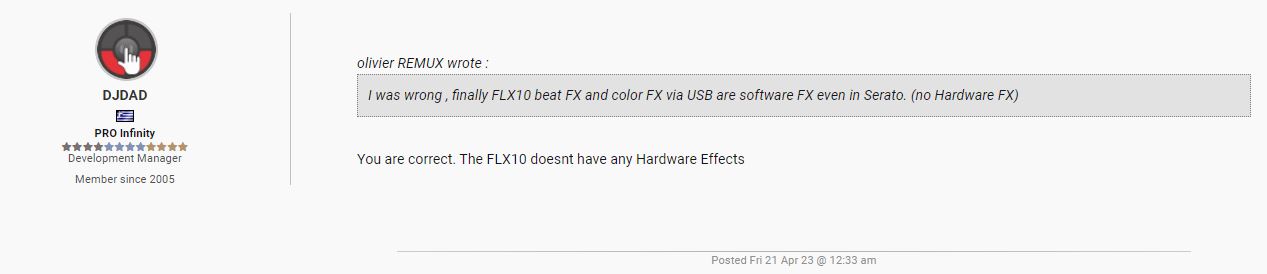

There are no hardware FXs on the unit - it can only trigger software FXs
It's actually already mentioned in this post:

DDJ-FLX10 is a SOFTWARE (MIDI) mixer with SOFTWARE EFFECTS (Both in Rekordbox and Serato modes) and therefore it's mapped as such in VirtualDJ as well.

[quote=olivier REMUX]Hi,
Incredible team :
they have fixed with new default script :
setting 'zerodb' 'default' ? get_level_log : setting 'zerodb' '-1db' ? get_level_log : setting 'zerodb' '-3db' ? get_level_log -3 : setting 'zerodb' '-6db' ? get_level_log -9 : setting 'zerodb' '-9db' ? get_level_log -12 : setting 'zerodb' '-12db' ? get_level_log -15
very good work (do the same for the DDJ1000 mapping vu meter -> it was the same problem :) )

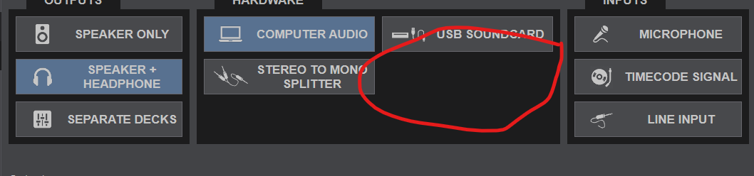

Hello
Virtual Dj is not detecting on lunch my ddj flx10 and I don't see the flx10 square inside the audio setup to click on it.
I installed the latest driver and Firmware and I installed the latest virtual dj too.
Windows 10 pro, I5-6300HQ,16GB,64-Bit.
Please help
Thank you
Please help
Thank you
