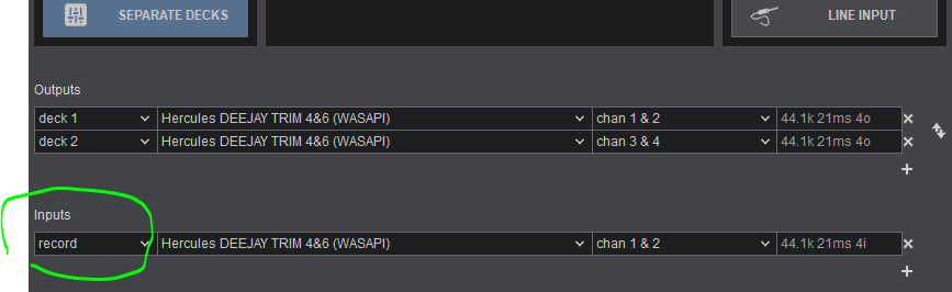

What you nee to do is add a record loopback, so that VirtualDJ records the sound output of the mixer
Aka, simply a cable from boot/rec/master out of the mixer, to a line in at the computer. And then add a "record" entry in VirtualDJ sound settings equal to this line-in.

Yes you just need to basically add an audio cable from the rec/boot/master out of the behringer mixer, to a line-in at computer (So VirtualDJ can hear your mix).
Then add a "Record" entry in VirtualDJ, equal to this line in. After that it will work ;-)

Your Behringer VMX100 USB has a internal soundcard (stereo in/out), you should be able to choose the behringer as line in record device.

If the mixer has a "line-in" as someone suggested above you can use that as record.
The "usb" part of the mixer, probably suggest that it has master to computer sound, via the usb.
And if thats true, you should be able to add the Behringer as recording device in VirtualDJ sound settings.

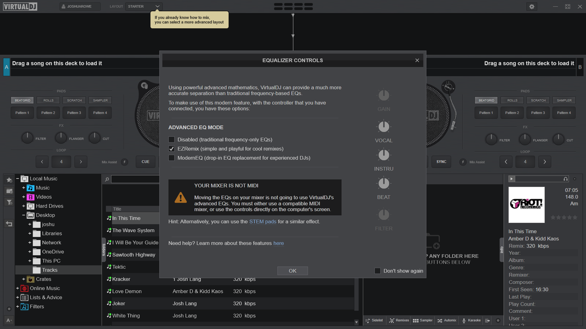

When I plugged my mixer into my laptop via USB I had this message when booting up Virtual DJ.
Posted Sat 22 Aug 20 @ 3:37 pm
When I plugged my mixer into my laptop via USB I had this message when booting up Virtual DJ "your mixer is not MIDI" I purchased this mixer the other day because it stated that it was plug and play with a laptop... Why does it say that it's not MIDI?
