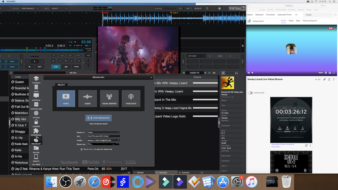

I only get this, as I have sad before, works ok with OBS, but direct from VDJ I only get this screen as shown on picture

did you sort this out? I am getting the same thing. VDJ says Im streaming. I get nothing in twitch or I get an error code in the video area, no sound but says Im live. I even see views but no video or sound.
