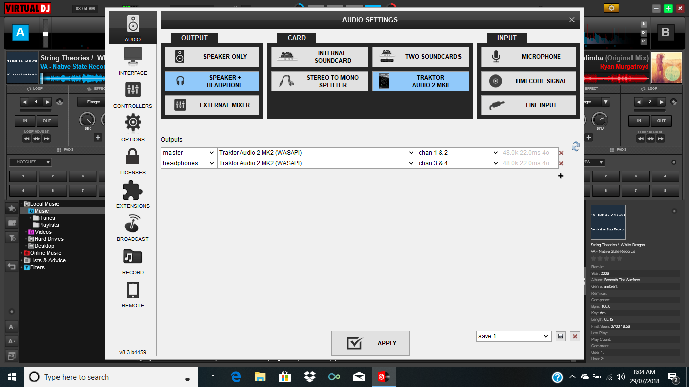

Perhaps if you posted a pic of your audio config in VDJ, we could see what you're doing wrong?
Use 'print screen' please - don't take a picture of your screen with a phone.

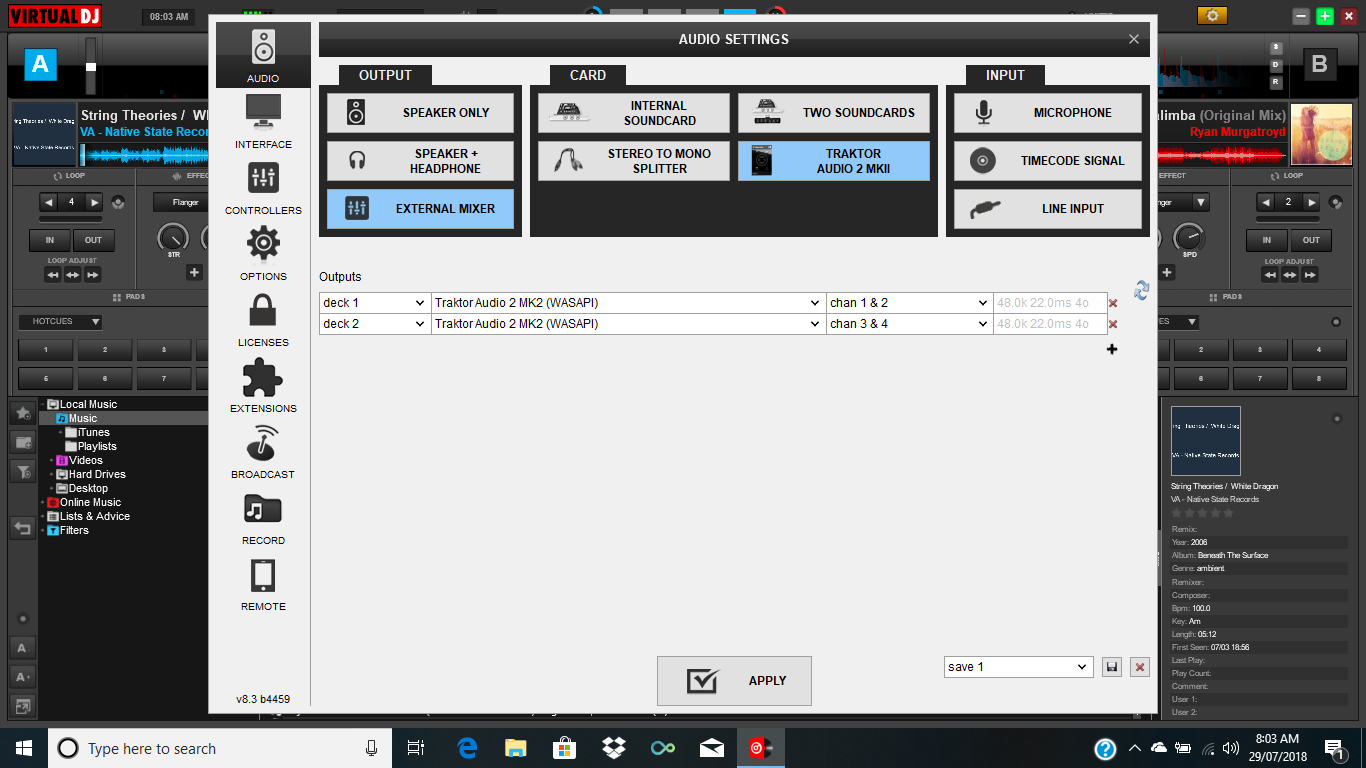

FragsPRO SubscriberMember since 2018
. Seperating sound from deck1 while queing deck2. Cheers Frags

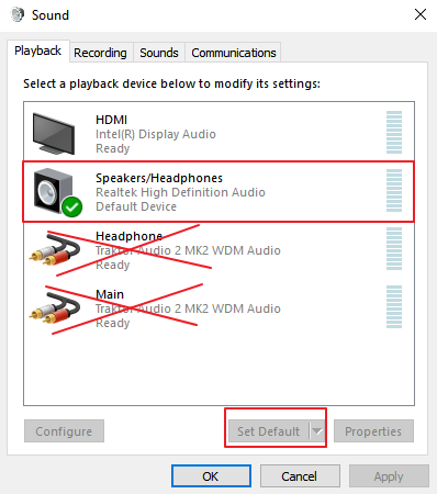

Please read this . http://www.virtualdj.com/manuals/hardware/ni/audio2mk2/index.html
Make sure you have installed the ASIO drivers in case you are on Windows.
Pay attention to the extra adjustments you need to do if you need to use External Mixer audio setup.
If you dont get proper channel separation, then select your computer's built-in sound-card as default playback device for your Operating System
Posted Sat 04 Aug 18 @ 1:14 pm
