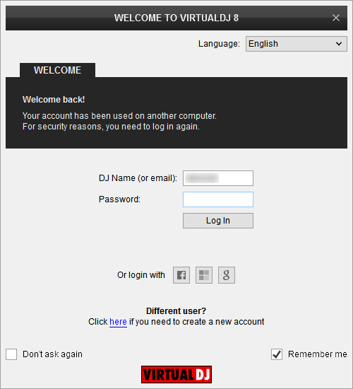

it's also keep asking me now to log in, re-login. Exit VDJ and check license and I'm log out. Need to login again and again.
Something is wrong.
Something is wrong.

Guess what, there's still a VDJ server issue. On one of my laptops, just got the account login prompt.

how many laptops are you logging in only 2 allowed at a time or else another gets logged out.

I only own 2 laptops. So its never more than 2 logged in at any time.

I am seeing the issue as well. It seems to be that now you cannot use your nickname to login. Don't know for sure but tried it several times and would not log me in just using my nickname. This happened just today and don't know what kicked it off and was not about logging into another computer or anything like that. Then I used my email to login and that seemed to take. The default name that comes up is your nickname and not your email. Not quite sure yet but seemed to help when using my email to log in. Have not had this happen before though.

Tried again... logged in using my nickname... this time it took and I was logged in... but when I restarted VDJ it asked me to login again. Then tried with my email and I was logged in... restarted and asked me to login lol... then tried again with my email and that took :) Have no idea why it happened in the first place and have no idea when it will happen again.

Never mind, I was logged out of my Virtual DJ software again so this continues to be an issue
Posted Fri 15 Sep 17 @ 1:53 am
Yup... just got it again... wonder if someone has hacked into the username / passwords ? I am constantly shutting VDJ down and restarting for development needs and have never seen this before except when I know I have logged into another computer and that is not the case now.
Posted Fri 15 Sep 17 @ 2:19 am
Since I'm the only one left posting about the login issue, lol, I have only one laptop with Virtual DJ running. 25 minutes and no logout.
Are we still able to use 2 laptops running VDJ simultaneously or is it down to 1 now? Or, is this still the earlier VDJ server issue?
Posted Fri 15 Sep 17 @ 2:21 am
